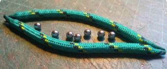

A sports sling, which is convenient to throw only balls, not stones. Why make the sling heavier?
The video used a universal sling petal in the color "Hornet" (orange + black paracord)"+ inner layer with metal balls to increase the weight of the sling. The total weight of the balls turned out to be 20 grams. +sling weight of 30 grams = 50 grams total sling weight. I make standard braided slings from paracord weighing 25-30 grams. Weaving and additional stitching of the sling in critical places creates rigidity and adds better control over the ball when throwing, and an additional mechanism with the insertion of a string with balls helps to accelerate the light ball faster and more accurately bring it to the long swing and the starting point of acceleration / acceleration of the projectile. This is the first trial version, I just started experimenting with reducing the weight of the sling without increasing its sail capacity. In the process, it will become clear in which areas the weighting helps, and in which areas it will interfere with the work of the sling. One thing is clear, such a sling is suitable exclusively for throwing tennis balls and light protective projectiles, and therefore is not suitable for throwing stones.

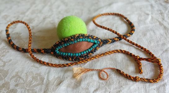

I tried to make an easier (for me) to build sling and accidentally created a “weighted pouch” in my Twin Loop sling.
https://slinging.org/forum/YaBB.pl?num=1781562326
Here is what I found:
The weighted pouch increases the tension in the release cord (that is, more weight pulls harder). The increased tension causes the pouch to open faster and cleaner. This, along with the heavier feel added to tennis balls, made tennis balls “nicer feeling” to throw and created a temporary increase in accuracy. I found the accuracy increase only lasted the first dozen throws only and then my body adjusts and all slings became the same accuracy.
The extra sling weight did reduce distance however. This is consistent with other users experience that lighter slings can get longer distance. In my case, surprisingly, I did not lose distance for the Figure 8 style throw. My thought is the Figure 8 has less acceleration time (or sling spinning distance), so the heavier sling did not have as much of a negative effect.
Note: my “extra weight” was in the exact center of the pouch.   You can place the weight in different locations. So please report how your sling performs. I was disappointed my “accuracy improvement” was temporary. Maybe as you move the weight around, the accuracy improvement can become permanent?

To increase the accuracy of the throw, I would advise you to try throwing from a braided sling in a geometry similar to Balearic. Smooth expansion at the basket and gradual narrowing to the tail and finger loops. This geometry of the sling does not overwhelm itself when the ball is dropped, and it is much easier to shoot at a target with such a sling. But of course everything is individual, you need to fully customize the sling for yourself. To make the loop comfortable, the most important thing is the dropping knot by which we hold the sling. The more we try different versions of slings, the more details we discover that can be improved and make our throwing better.
I was lucky to work in a shooting range with very good archery athletes. The guys are members of the national team, participants of the world Championships and the Olympic Games. Professional athletes-they explained how to build their workouts, keep a diary of training records and their results. In this way, it is possible to monitor and gradually improve shooting techniques and the constant adjustment of shooting equipment. I think it works the same way with a sling. For accuracy, in my opinion, you need to keep your own statistics. Not single shots, but full-fledged series of a large number of shots for the result. Record them and analyze both the equipment and the equipment we use.
To identify errors and work on them, we need the most identical shells. Tennis balls are great for this. You can practice with them every day at almost any venue.Throwing stones is certainly very exciting, but not everyone has the opportunity to find the same ones and have the opportunity to train with them regularly.

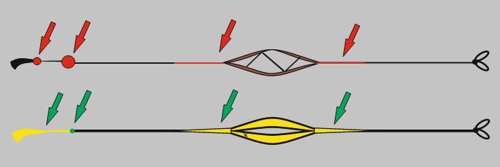

Places where, in my opinion, it is desirable to change the design of a thin sling for throwing a tennis ball!
1- I would remove the massive release and whip nodes. 2- increase the stiffness in the basket area. 3- Add the weight of the sling in the basket-this will give the ball good speed and make it easier to feel when throwing.

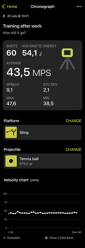

It seems your statements are becoming too categorical. I can agree that single-strand lines are HARDER to throw, but I don't agree that they are generally WORSE in terms of performance.Furthermore, thin webbing can also be flattened like a noodle, which will reduce its deflection due to the stiffening rib. For example, by using dyneema and rolling it out, or by sewing two cords together, as Sarosh did.
To keep the discussions constructive and not based on feelings, I suggest moving on to clear metrics.
For example, here are measurements from a typical workout at a relaxed pace with a thin strap and a ball. It shows the average speed, and below is a stability graph.
Speaking of accuracy, you can check out my Instagram (the button is under the post) and watch a few relatively recent videos. And don't get me wrong, I'm not boasting about excellent accuracy, my experience is only about two years. Another example is the Pansling. It has good accuracy and power with a single-strand sling (balls and stones).
What I mean is that if you compare the overall accuracy and grouping of a sling, I don't see a HUGE difference in performance, considering the design alone.
