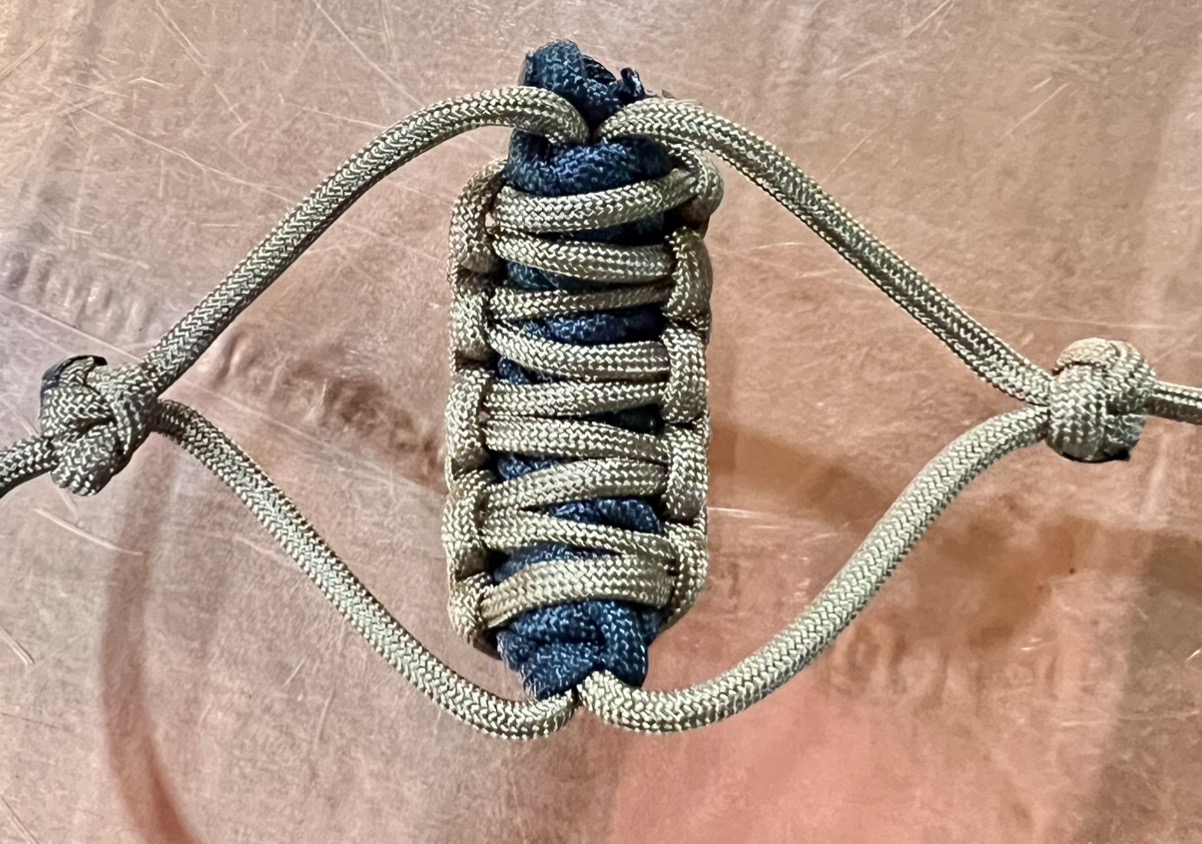

This is a new version of the Twin Loops sling that was made by adding a cobra weave on top of the west country whipping at the pouch center.
The cobra weave added 31” of additional paracord on top of the 33” of paracord used in the west country whipping. Per google, the paracord weight increased from 6.2 grams (WCW only) to 12.5 grams (WCW+cobra) at the pouch center.
Compared to a 59 grams tennis ball, the weight added by the paracord to the pouch center went from making the tennis ball feel 10.5% heavier (WCW only) to 21.2% heavier (WCW+cobra).
Pic of new sling shown.

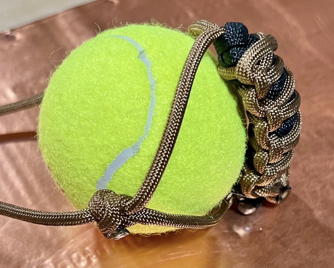

Re: New sling makes tennis balls HEAVY!
Reply #1 - Jun 15th, 2026 at 6:26pm
Another pic. Looks funny!   But wow, does it really work!

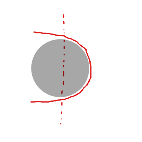

It's not about the release cord being in front of the ball (although that can absolutely happen).  It's about the direction the projectile moves when the sling is released.  The projectile will try to move in a tangential line to the arc of the sling.  But the sling is in the way because it's still rotating.  It's literally just for a split second, but this happens with any projectile and any sling.  You can see it pretty well in this video from Goober: https://www.youtube.com/watch?v=rEUM6-XarKM.  Thinner and lighter slings will interfere with the projectile less.  Which is why they tend to have faster/cleaner releases.  You mentioned the tennis balls going to right.  That means you're getting a cleaner release from the sling.  Strangely that's not necessarily a good or bad thing.  It depends on the slinger and what they prefer.
