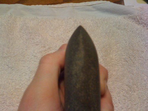

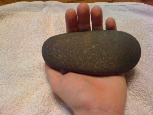

this is my lastest project Smiley
it turned out better than i expected. i almost dont wanna put it in a handle .
but all i have to do now is make a handle. it shouldnt be to hard to whittle it down after i find a good peice of wood

the edge

Wow, thats really good! How long did it take to make?

great celt, aztec! yeah, just exactly how did you grind it down?

wellllll.. i did try pecking lol and i gave up quick so i used my bench grinder to rough out the shape and to get my edge at an angle .but 75% of it was done by grinding it on other round and flat rocks i found at the river and then i used sandpaper. while i sat around and watched tv i would be sanding it and after 2 days its pretty darn slick.
i just got back from the woods and i got a good section of dogwood for the handle.
as hard and dense as it is itll take me awhile but itll be worth it

what do you have on your bench grinder? is it the standard pumice wheel that comes with it, or something else?

the one i used for this was a wheel thats for sharpening tools. its a lot finer than the standerd wheels

hmmmm. is it a six inch, 8 inch? how long on the grinder before you had it shaped?

the celts almost 6 inchs and its 2 and a half on the wide end.
it took.. maybe 45 mins of grinding untill i was satisfied. and after that it had flat places all over it from the wheel but the rocks i ground the celt on took alll that out. Smiley

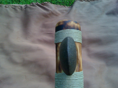

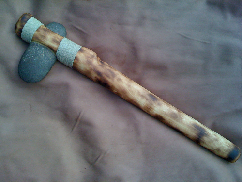

all finished  Grin
i slung a rock into the air! &&where it lands i know not - ow
aztec
Posts: 858
Re: celt axe
Reply #13 - Aug 9th, 2009 at 7:17pm
this is my new favorite weapon/tool
