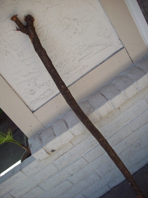

today i got ahold of a small trunk from my nieghbors bottle brush tree. i decided to make a couple of atlatls and a 'rabbit' or throwing stick out of it.

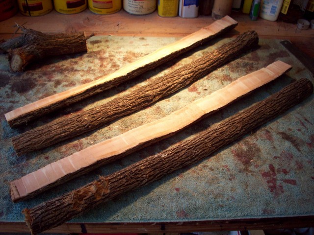

Reply #1 - Jul 29th, 2009 at 10:30pm
i cut it in half and split it lengthwise.

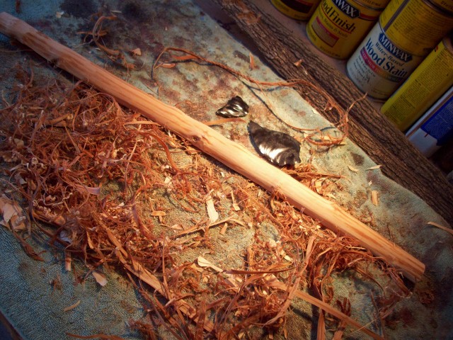

Reply #2 - Jul 29th, 2009 at 10:32pm
i set aside three staves for future use and got to work shaping the rabbit stick.

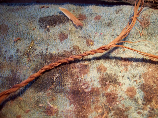

the wood, despite being extremely tough, works very easy. and as a bonus the inner bark makes great cordage.

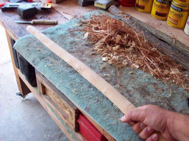

Reply #4 - Jul 29th, 2009 at 10:36pm

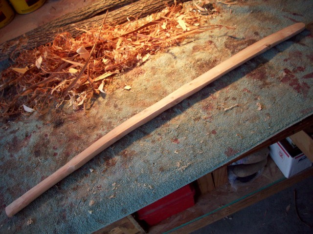

i had the rough shape in no time. one side flat, the other rounded, and a simple handle are all that's required.

Reply #5 - Jul 29th, 2009 at 10:38pm
rabbit sticks are left/right dependent, so if you are a right hander then the curve faces forward and the flat side is down.

this shape acts like an airplane wing in that it generates lift when thrown, keeping it buzzing just above the ground for a long distance.

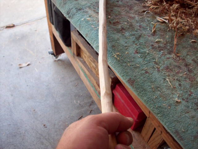

Reply #7 - Jul 29th, 2009 at 10:41pm

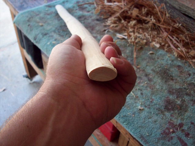

here's another view from the handle end.

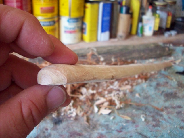

Reply #8 - Jul 29th, 2009 at 10:42pm
and again edge on.

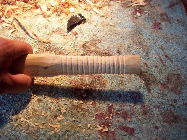

a little detail on the handle...

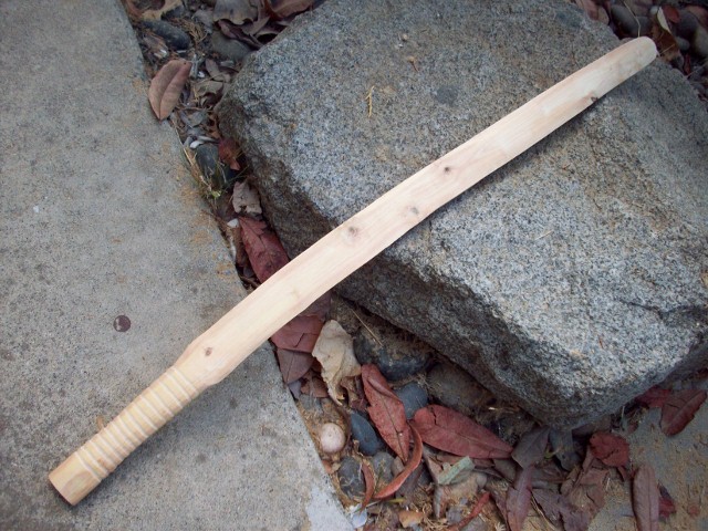

Reply #10 - Jul 29th, 2009 at 10:46pm
and, voila! spinning, buzzing, rabbit killing stick of death! it may seem simple, but this was the primary small game hunting weapon in the southwest region for thousands of years.
