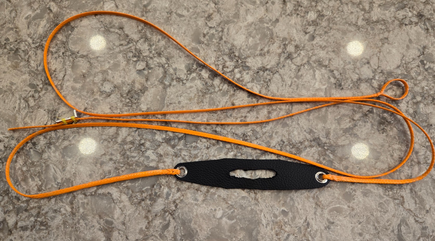

Fun little distance sling I made for smaller ammo like golf balls and lead glandes. 2mm dyneema cords, a light leather pouch, 41", and only 11g!
Throws pretty great, except man does that leather add some crazy spin! Gotta make sure your release is perfectly aligned, but if it is holy cow does it fly.

Not a lot of distance slings get posted here. Cool to see yours. 41 inches is a good length in my opinion.

I think that rolling the cords flat on a distance sling does not help but hurt the ability to control the orientation of the pouch. A flat cord naturally wants to orient its broad side against the wind. This can cause fluttering cords or other issues. If for a split second only one cord turns its flat side against the wind, then your pouch will turn in directions you dont want it to. So I would suggest round cords for air resistance reasons and controllability. I think that the reasons why you rolled it flat are the reasons why you shouldn´t roll it flat. Wink

Huh, good point! I actually didn't do it intentionally for wind resistance, it's just a habit I have when working with dyneema.
I'm not experienced enough with distance throwing to know if that's what's happening here, but I'll see if I can unflatten it since your logic is sound, especially when dealing with very thin/light cords that are very long. Fortunately dyneema slowly unflattens(somewhat) over time on its own as the waxiness from the color treatment wears off.

That one kind of looks like one of Capt Pauls slings
I'm a sucker for leather pouches. Even on the grain side I get great spin in spite of my mediocre technique.

Oh yeah that's the backside of the pouch in the photo - I always do fluffy side facing the ammo for better ammo security. And yes, that also gives it immense spin!
The pouch design is based on Larry Bray's record-setting sling, but with a larger slit to work with golf balls since his was only for small rocks and lead. I worked out a cleaner template after making this one. The slit is really messy on this one from all my experimentation.
That's a great observation.  I never thought about a cord catching the wind as it was moving through the air.
I think I'm the only one who does it the reverse.  At least I don't know of anyone else who does.  The reason is because of slinging with ice balls.  When they melt on the raw side, the next ice ball will freeze the moisture and literally stick to the pouch.  The finished (smooth) side is obviously much more resistance to that.  For tennis balls, stones, or whatever else I agree, smooth side out.
