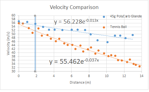

This was the velocity drop that I got from mapping out position with a camera (from the side) using somewhat calibrated images.  Take it with a grain of salt, but the drop in speed is quick. (this is given in m/s)
Attached is a video of the test. I placed 2 tennis balls on the ground at 5m apart and slung over the top and in line with both of them (to try and keep the distance/pixel accurate). I used the spatial calibration of the distance between tennis balls for the entire image. It seemed to be pretty accurate because my calculation said release speed of 56 m/s and the radar was 55 or 57... I don't recall, I just remember it was 1m/s off of the camera calculation.

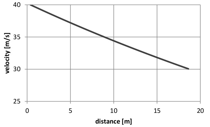

If we have an average velocity of 77 mph (~34.5 m/s) over the 60ft 6" (18.44 m) and assume a terminal velocity of the tennis ball of 25 m/s, then this is the velocity drop over the thrown distance. The initial velocity is a bit over 40 m/s which is about 90 mph.
If the terminal velocity of the tennis ball is more at 21 m/s, as some sources suggest, then the velocity drops even more which means that your initial velocity was a little bit higher.

Reply #5 - Aug 23rd, 2026 at 8:03am
Thanks so much for the help!!
Flint:  i was calculating a lot of the throws at 94 mph.  That agrees with your comment the speed could be a bit more than 90 mph if terminal velocity changes.  3 of the tennis balls were brand new and the others were used from 1 to 3 months. “Fuzziness” and drag differed I am sure and terminal velocity possibly could change.  So this helps show my calculations are not completely unreasonable.
Irongoober: 56 m/s is 125 mph!   Obviously it is a fact you are way more skilled than me.  If I am mid-90 mph (maybe 100 mph) that would be consistent with the expectation your speed is way higher than my speed.   So maybe if I claim a higher terminal velocity and add a little speed to Flint’s calculations, and the result is my small addition still remains very far from your speed….well, that helps show perhaps the numbers aren’t horribly inaccurate.

Reply #6 - Aug 23rd, 2026 at 12:05pm
oops. the graph I put up disappeared. I fixed it.
@Bandit I was just trying to point out that the drop in velocity is very fast, nothing about our relative speeds.
I get about 30% drop (over 20m) between the release speed and average speed, so that is in line with what you calculated. You could have been hitting 100mph with an average speed of nearly 80mph.

Posts: 507
Re: Video frame counting for speed - kind of works
Reply #8 - Aug 23rd, 2026 at 3:08pm
Wow this is great data! Crazy that it drops speed so much faster than I thought. If only racquet balls were a little heavier and cheaper, they'd be a much better practice ammo.
That's three different sources with effectively the same outcome, pretty well confirmation there barring some much more in-depth tests which are probably not worth the effort(and will probably show the same result).
