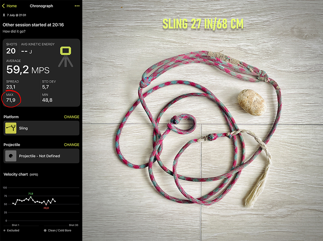

Reply #9 - Jul 8th, 2026 at 1:15am
I continue to take measurements.
It has become clearer how measurements are counted when the radar is located behind, but it is still not clear how best to position and throw stones when the radar is in front.
Yesterday, for the first time, I managed to record a speed just above 70 m/s, even though I recently thought 60 m/s was my limit when reading speed from video frames. After all, radar significantly speeds up the calculations in this regard.
A 27 inch long sling and a stone weighing approximately 30-40 grams were used.
