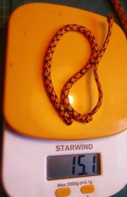

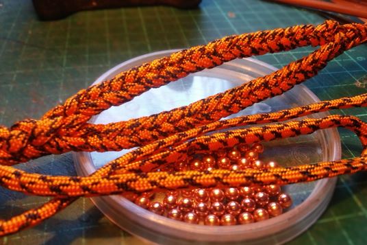

erricrice, That's right, you almost completely understood me.  The point of the post is not to convince you to throw a tennis ball with thick slings. My braided slings are quite thin and the extension is only at the basket of the sling. The point is to weight the basket with steel balls, which allow the basket to be flexible. Weighing the sling by 15-20 grams will allow you to feel the weight of the ball better. Of course, this is not necessary for a stone, and it will not help, since the stone itself has sufficient weight. Additionally, it will help if you increase the stiffness at the point of attachment and transition of the edge of the basket and the beginning of the transition to the body of the sling-this will give a more predictable descent of the ball-due to the right opening of the sling. We can see this on all the slings from the authors who sell them on the Internet.Increased torsional stiffness and stiffness in critical areas.
The task is to increase the weight in the ball area and at the same time keep the sling as thin and rigid as possible without loss of flexibility.

There is no difference between a hard sling or a soft one made of a single rope or a braided one made of a paracord or a dainima. Just stuff a piece of paracord with balls so that the weight of this piece of balls is 15-20 grams and sew it in the center of the sling basket and that's it. When you throw your ball, it will no longer feel like 55 grams, but much more. Just make one such sling and compare it, I am very interested in your practical opinion after using such a sling.
The only drawback that I found when using a weighted sling with balls is that it accelerates a lot and clicks louder. A brush with a whip cannot stop like an ordinary light sling, because of this it hits the hand quite noticeably after being thrown. But if you use a long-sleeved shirt, it protects your hand from bumps. In hot weather, it will probably help to use a leather wristband))
