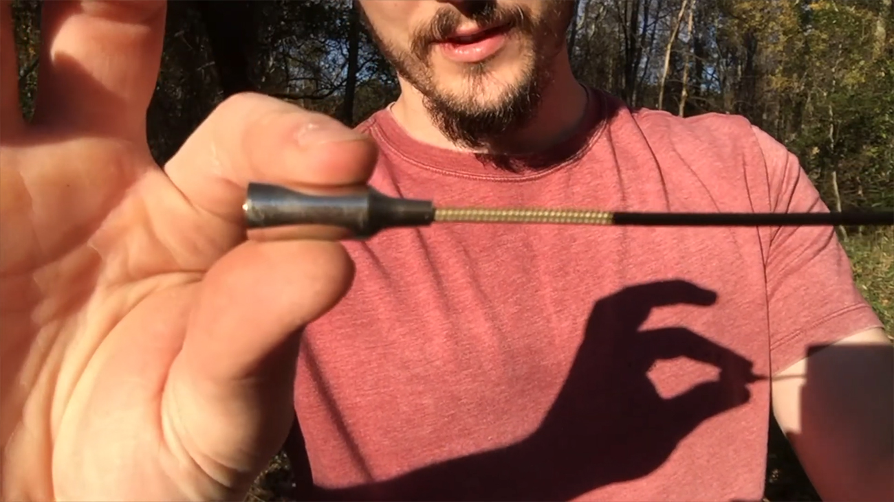

The Youtuber Acroballistics invented a very effective and popular release mechanism.
We call it the "acro(ballistics) tab".
Hi everyone!
Actually, this isn't a reply to a specific message, but rather a general comment on the topic of "trigger mechanisms."
I also remember that Erricrice made a metal one, so take a look at what I came across on YouTube today:
https://youtu.be/n1ZsbARgp2E?si=5D2MaKgyh9Bof7_B&t=484
Screenshot attached.
I don't know how practical it is, but it looks interesting. In the video, the creator says it's part of an arrowhead, though it also somewhat resembles a cartridge casing.

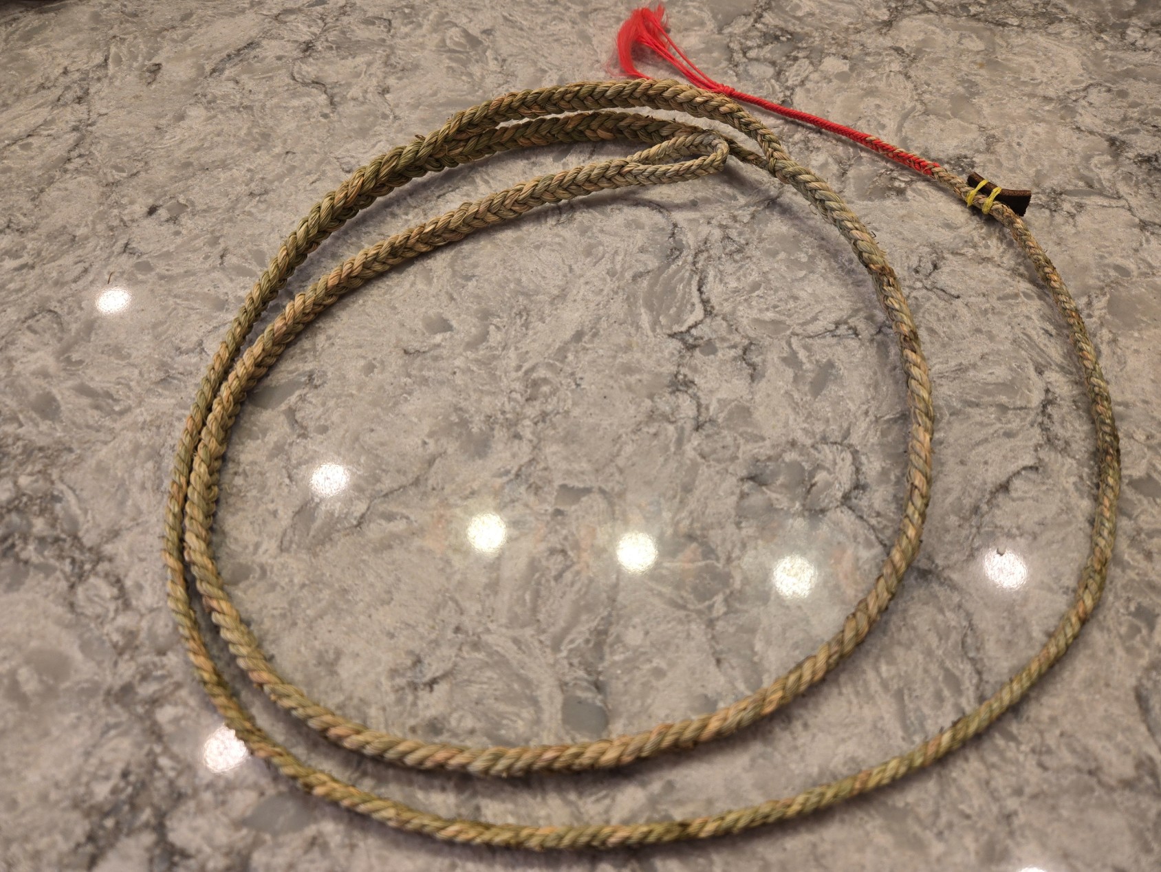

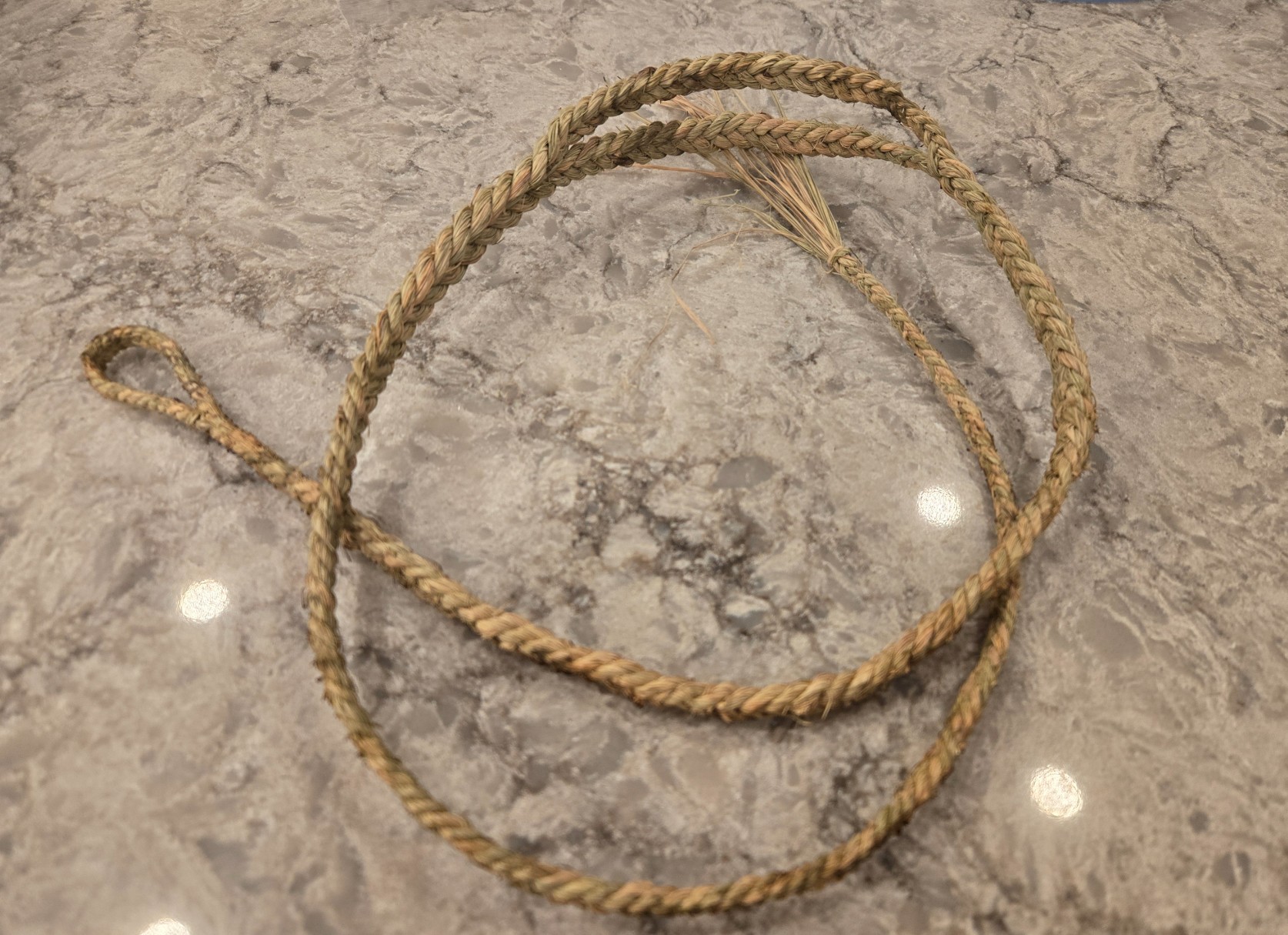

In other news, I finally got my hands on some esparto! My first one was pretty messy, but after some pro tips from Raul(wet the fibers briefly, sit them on a dry surface for 10-30 minutes, then braid while they are still damp) the second one came out pretty good! Still a lot to improve, but plenty good for me.

Very good work as usual ER! Thanks for sharing the dampness tip. If i ever get my hands on some esparto ill know what to do!

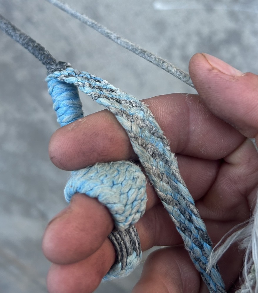

and a more complex and effective design i made with a fingerloop / wrist wrap that is incredibly comfortable. ive thrown heavy ish rocks with this 2mm release cord for 4+ hours consecutively with no sign of blister
neither option protects the thumb but ive never had an issue there.

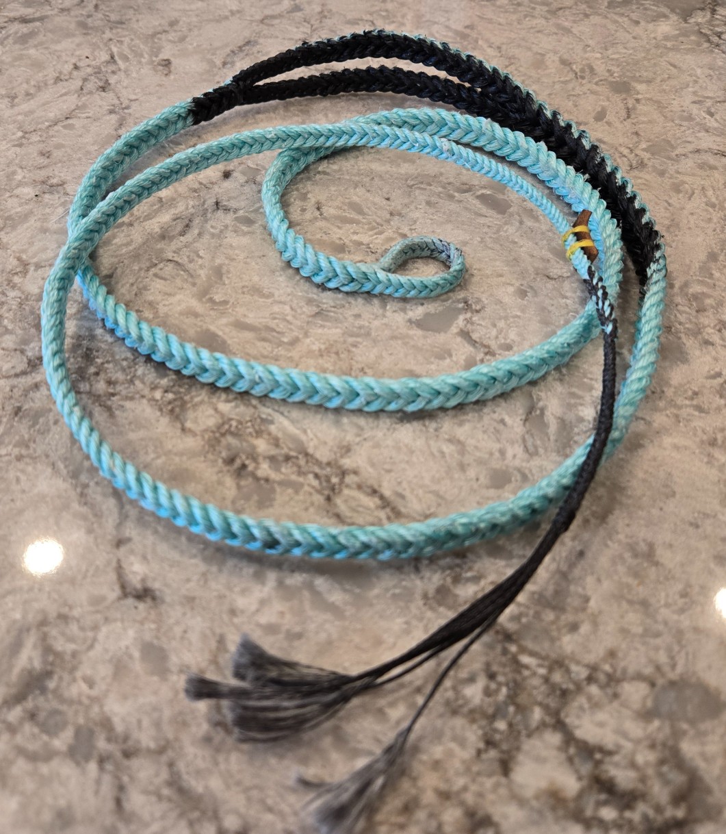

Some more polysteel off the assembly line! And I've been experimenting with plastidip on the pouch to increase grip and prevent smooth rocks from slipping. Not particularly durable, but as long as it keeps the surface grippy, the polysteel can take the damage.

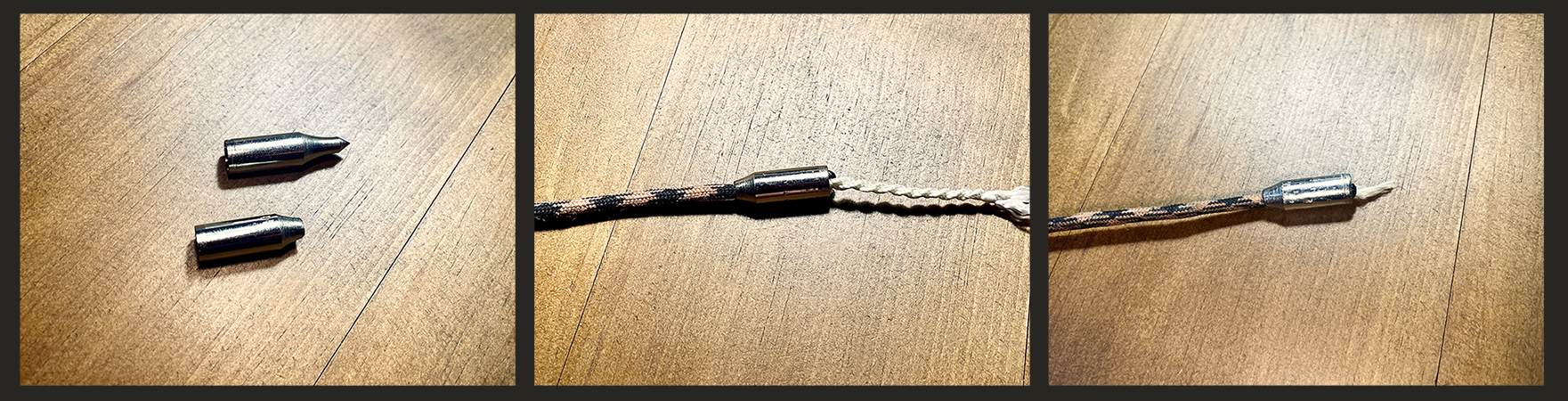

The tips arrived. I drilled them, filed down the ends, and fitted them onto one of my old slings to test them out.
I managed to try them out this evening.
Overall, it’s comfortable to use with your fingers. I didn’t encounter any issues with it being slippery—unlike the experience Erikris described with a metal version, for instance. That might be because your fingers rest against the narrow section here, rather than just gripping the surface.
But there are downsides.
- You can forget about the "cracker" click entirely. On top of that, at the end of today's 300–400 throws, I discovered that the cracker had simply been sheared off by the trailing edge of that "sleeve."
- The tip has some weight to it, so if the rope wraps around your torso at the end of the throw, that’s fine. But if it hits your palm or fingers, it’s unpleasant, to say the least.
- And yes, even though I filed down the leading edge with a needle file, it looks like it's still cutting the paracord sheath...

If you cut off most/all of the cylinder part so just the cone is left, that would save weight and likely reduce wear once filed smooth again. you could add a sacrificial layer of tape or something between the metal and the paracord. still though, its unforgiving metal rubbing constantly against the most active part of the sling.

Thanks! 28 inches this time around. I think I'm growing out of my short slings phase and back to my standard again. Only after worlds though Grin
