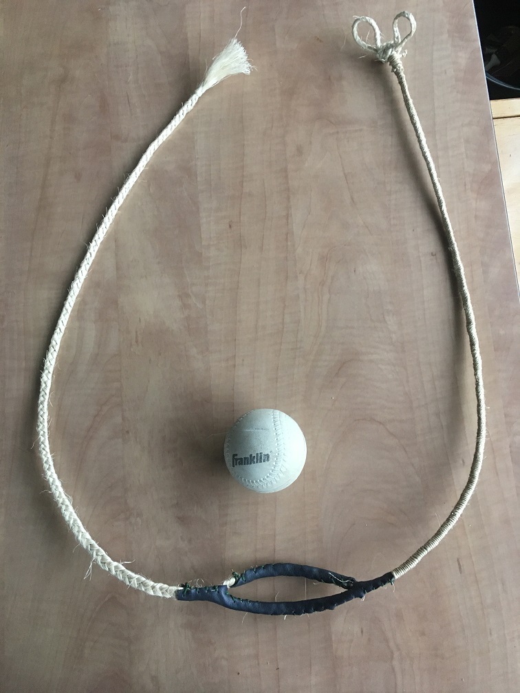

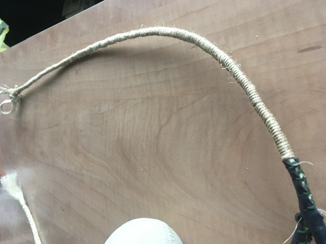

Great success !!!!
Whipping laid untop a 3 strand retention cord braided from loose fibre
This makes the sling much stiffer, stable and responsive to the wrist without having to resort to ultra thick cords or extreme tight unaerodynamic square braids, instead its round and all naturel !!!
Say good bye to cords twisting around each other while twirling...
Thats a rubber baseball for reference

It is hemp whipping over a 3 strand sisal core

I will admit that is a great idea.  Grin
I've been meaning to try a different method but not sure how to do it. Might have to give this a try first.

Outstanding! I agree, that is a great idea. Seeing it in action would be welcome.

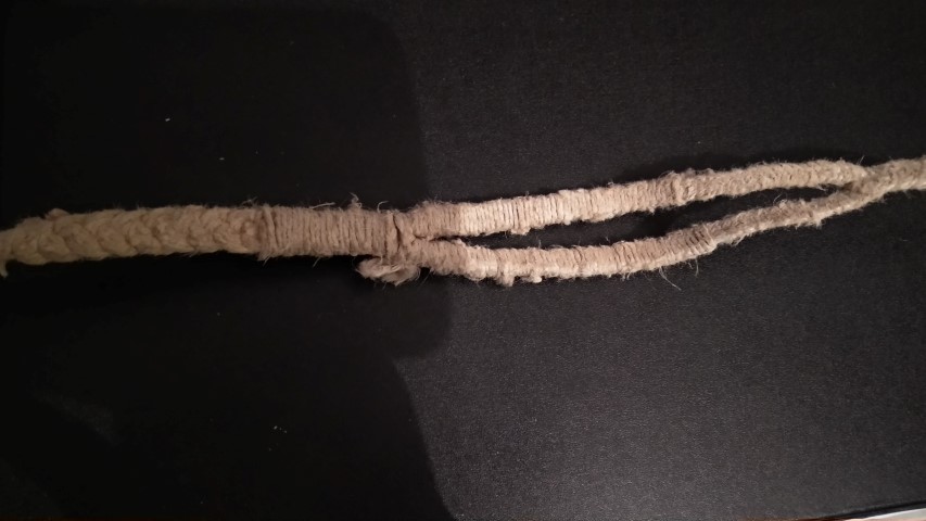

I am doing this on the split pouch instead of leather protection, much better and easier to apply, replace or fix.
I was thinking of a sling core made by cords (not braided for minimal stretch) and whipping around them to keep the cords together, I did a short sample and didnt like that it would take too much time to do the whole length and added mass without adding breaking strength (performance over durability).
Whipping is great protection I dont understand why there aren't more split pouches with whipping protection.

a quick pic of what I'm talking about

Looks smooth!

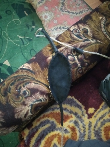

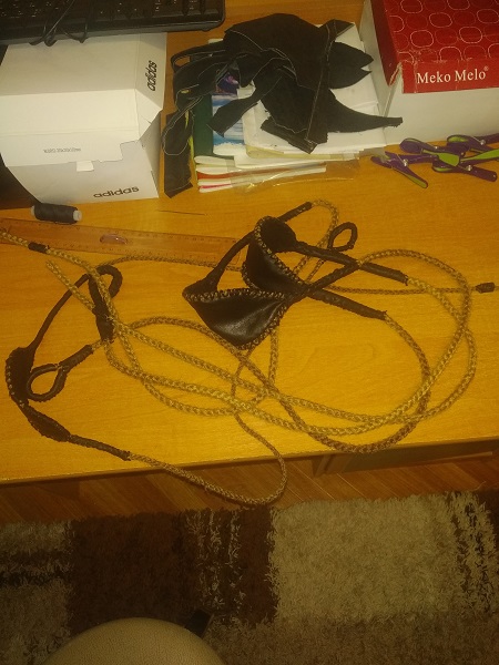

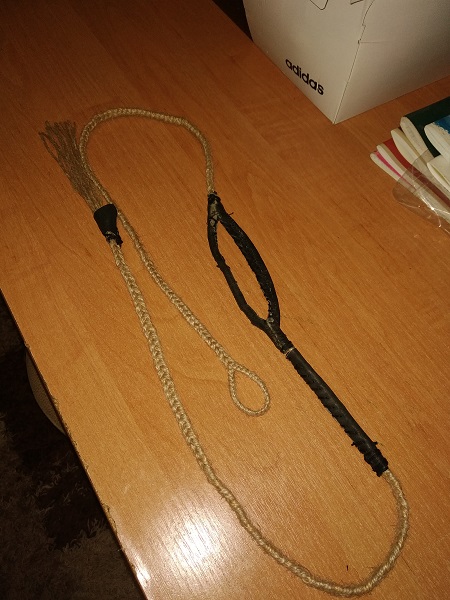

Apache slings and split pouch sling

Love me some Apaches!  Cool Cool
