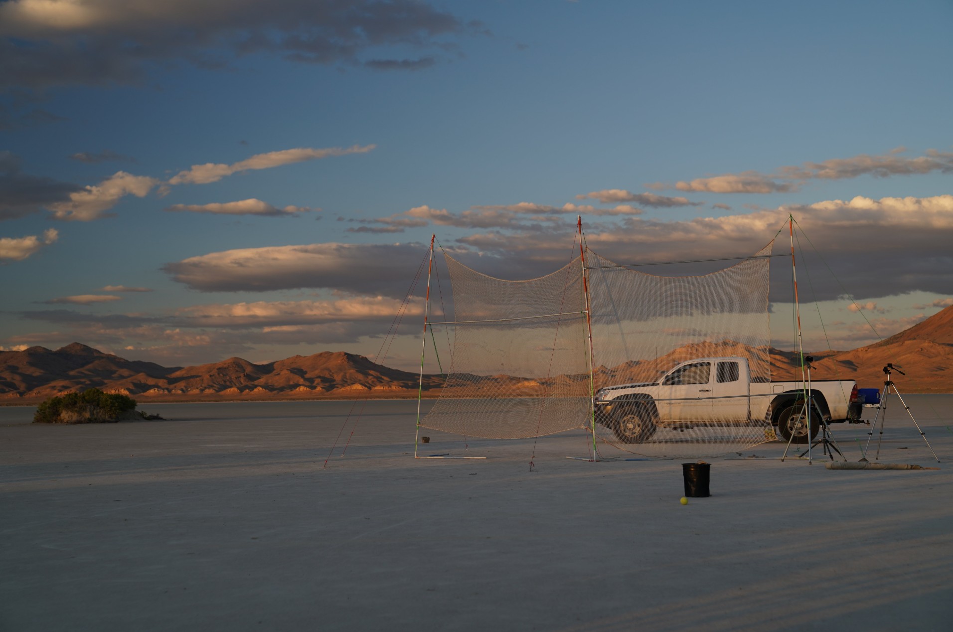

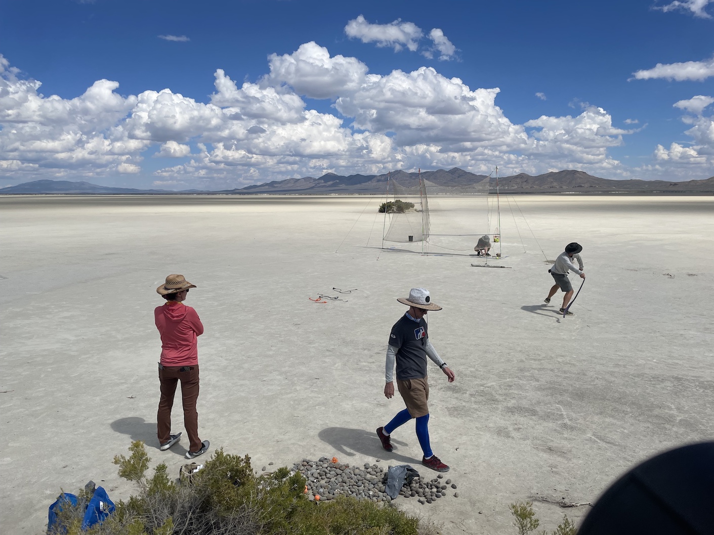

I brought a net to keep people safe in case of slip outs and it served a nice dual purpose for warming up with tennis balls.
We each warmed up, then threw 10 of one type of projectile each. After throwing we went out and looked for the impact. For many of the shorter throws impacts couldn't be found, so we just used the projectile location.

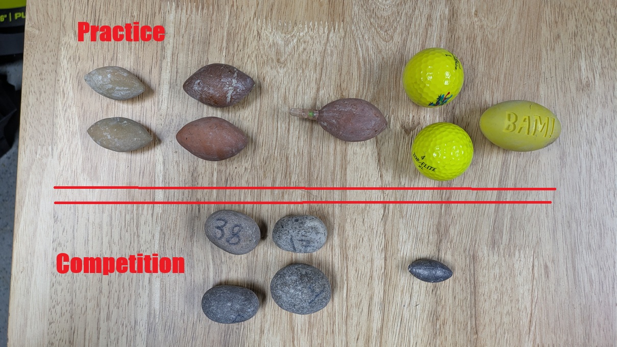

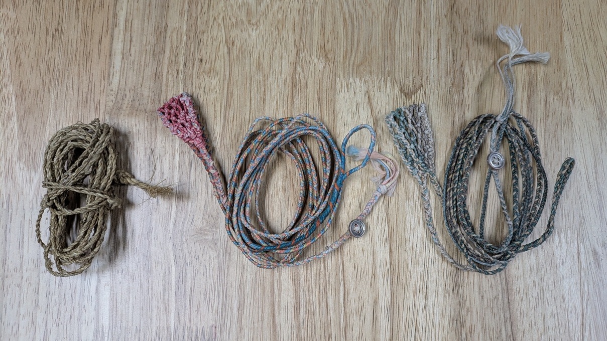

Here's a picture of everybody and the types of projectiles and slings used.

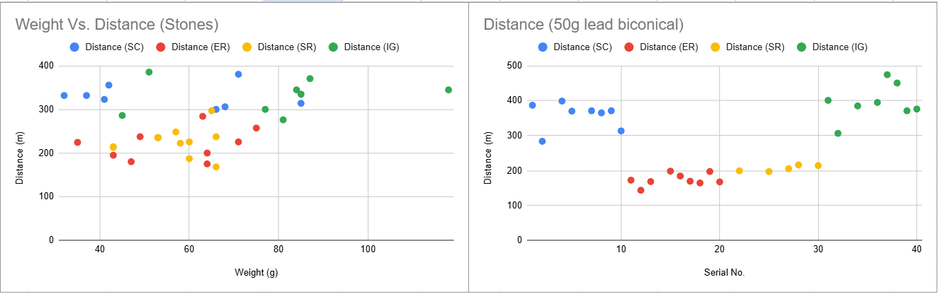

The results are in this graph.
Best throws:
Stones:
IG: 386m, 52g (impact)
SC: 381m,71g (impact)
SR: 297m,65g (stone location)
ER: 286m, 63g (stone location)
Lead (50g biconicals):
IG: 475m (impact)
SC: 399m (impact)
SR: 217m (impact)
ER: 199m (impact)
Thanks everyone, hopefully we'll all see each other next year.  It's always the weekend before Labor day, so it will be the same dates next year (August 28-30)

Thanks for sharing and congratulations to everybody. Those are some great numbers. All of them. The 450 m claim that is on the welcome page of slinging.org is definitely backed up by this competition.
When I do distance slinging, I donīt search for impact points. Not because I get higher distances when measuring to the location where the projectile is laying, but because it is nearly impossible to find the impact point on a harvested corn field (where I do most of my distance slinging).
@IG: At what distance was the lead projectile found, that hit the ground at 475 m?
And another (slightly related) question: Was the David Engvall throw from 1992 mesured to the impact point of the projectile or to the place it was found?

@FF The main reason we go to this location is because finding the impact point IS possible. Nearly everywhere else I've gone, it is nigh impossible to find the impact.  One issue with such hard flat ground though is that some stones rolled a long way. One stone, we're pretty sure, rolled ~100m (after impacting at 306m).  We found one of swiftcreek's clay glandes at 416m, but couldn't locate the impact. Most clay verified impacts were about 350m (the longest was 376m), so even those were prone to roll quite a way.
Another interesting thing to note is that with all of the throws and found projectiles (10s of impacts), we can now say conclusively, that biconicals reorient in flight like an American football (nose-up to nose-down).
As far as I know, both Larry and David's records were measured at the point of impact. Larry explicitly said that in one of his posts that I found and said that he had conversed with David regarding the record (because Larry wanted to go back and claim it, especially given that David's wasn't with a traditional sling) so I believe they were done the same way.
My glande was a few meters farther, I don't recall exactly, but it was likely beyond 477.1m. We were only marking impacts. Find the projectile, pick it up, find the impact, place the projectile by the impact and flag it (we had serial numbers on the projectiles).
In hindsight, I should have got a more official/accurate measurement. The flight archers have a surveying laser range finder (AKA 'Total Station') that is much more accurate than mine (used for hunting).  But we have at least 3 people that measured it and we measured with 2 different range finders. I got 475m, and the other range finder got 474m, so I took the higher number.

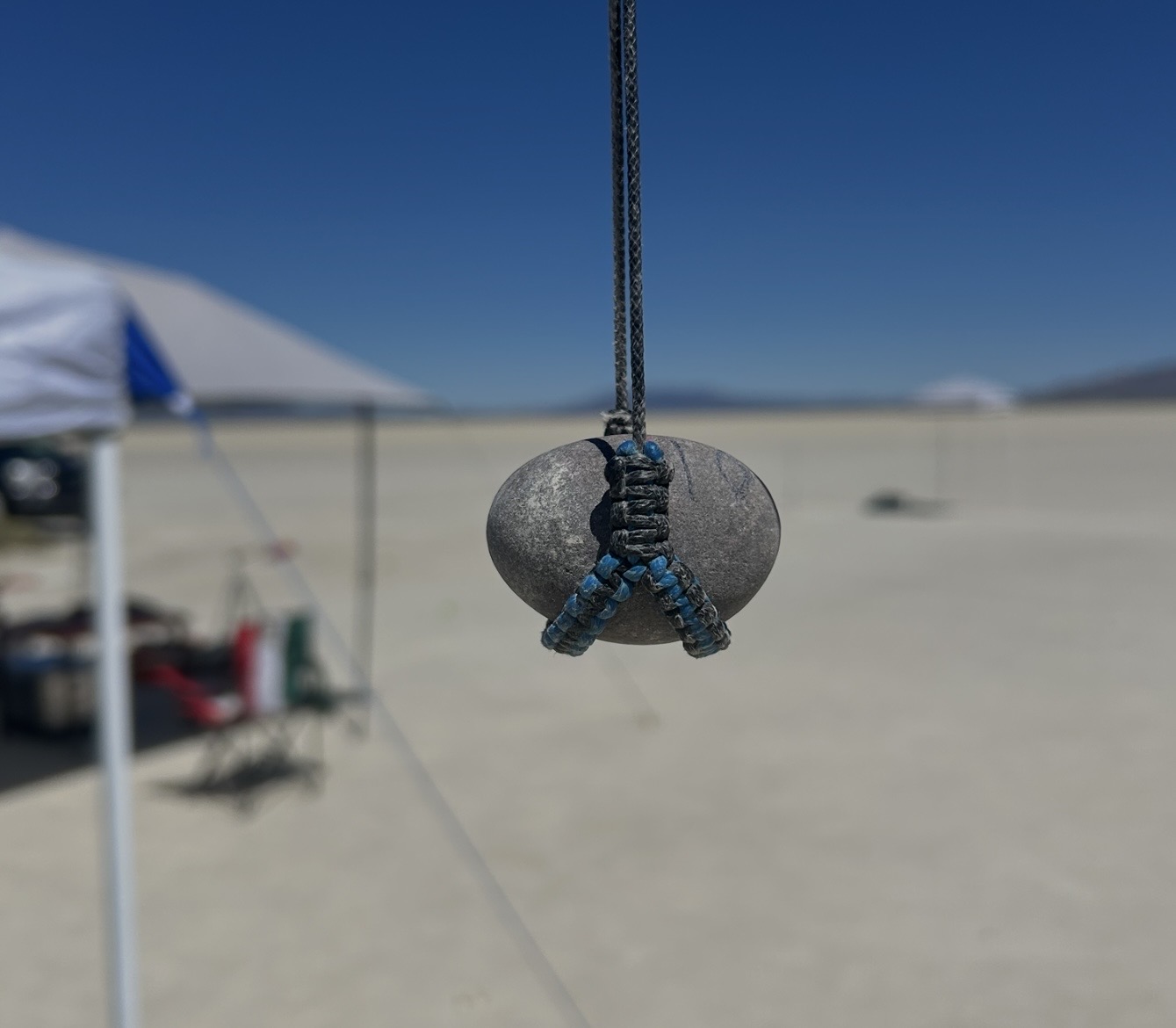

Heres the 71g stone and sling i used

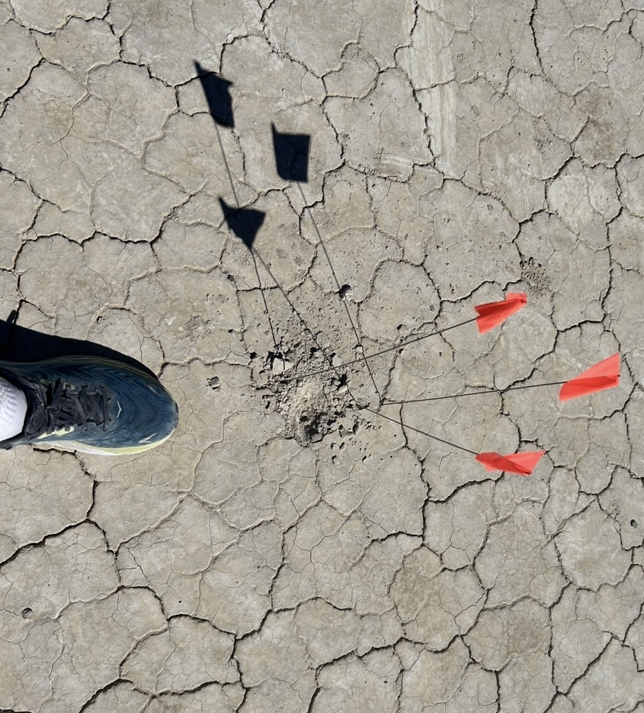

Also heres what a lead impact at 450m looks like
