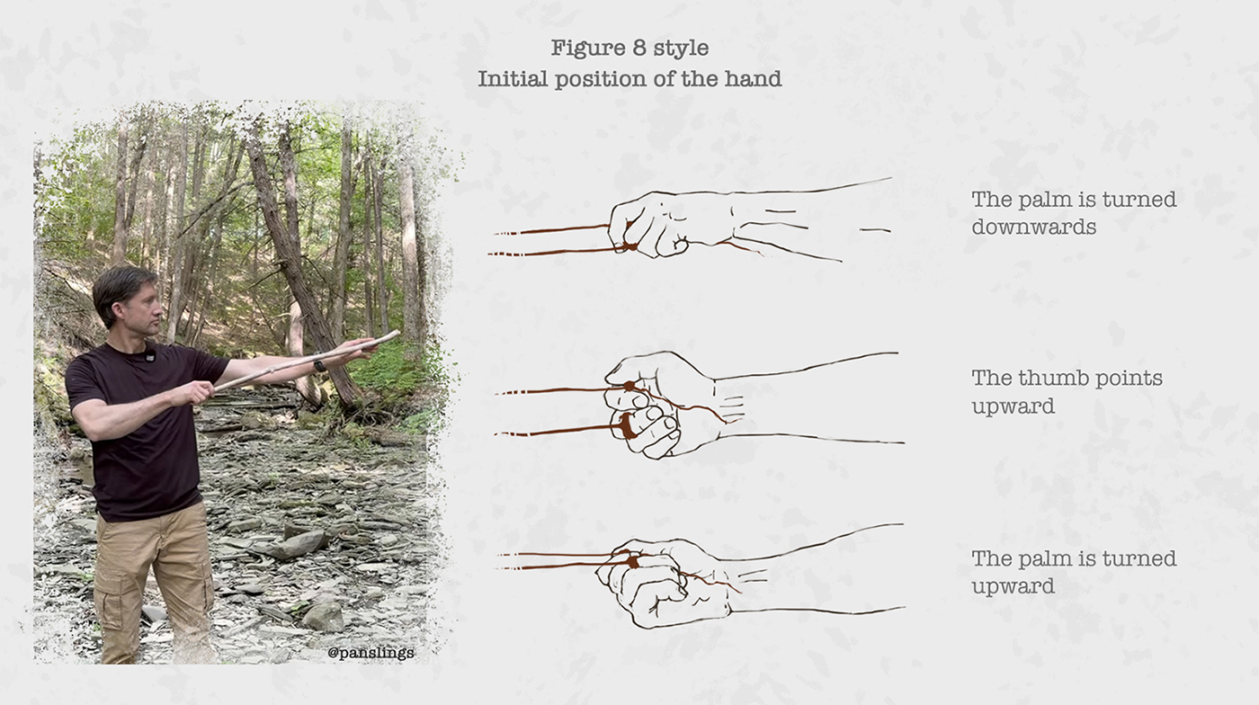

Hi,everybody!
The figure 8 style is one of the main ones I use when I need an overhand.
And this style is one of the first that gave me good results.
I learned to understand it from Pansling videos, which is why it’s included here as an example (I hope he doesn’t mind).
But here's the thing. I still can't quite figure out my primary hand position, and it's still an open question. My hand position varies, but most often it's palm up, which allows my elbow to be more closely pressed against my chest and less likely to swing outward during the throw.
In the figure, I've compiled three basic starting hand positions. I'd love to hear from other participants about which position they prefer and why. Have you noticed any influence, and why did you choose it?

The middle position, thumb points upward. With a vertical throw, your knuckles should be stacked vertically, kind of like how you would be holding a hammer for an overhead swing. This should result in the sling cords also being stacked, letting the projectile flow right out.
Rotating your palm down (pronate) or up (supinate) can add spin left or right which can lead to some wicked cool trajectories. I am no where skilled enough to put that into practice though.
I really like the graphic, but it looks like the top picture is of a left hand and the other two are right hands.

Rhodophyta wrote on Aug 10th, 2026 at 11:57am:
Actually, that's not entirely true, since I often throw from a palms-up starting position. And here's another point. Perhaps one of these positions can impart additional spin to the projectile, which can be beneficial for lift. Perhaps the combination of the starting and finishing palm positions is important.
Yes, that's true. Please ignore this, I noticed it while I was already drawing. Smiley
