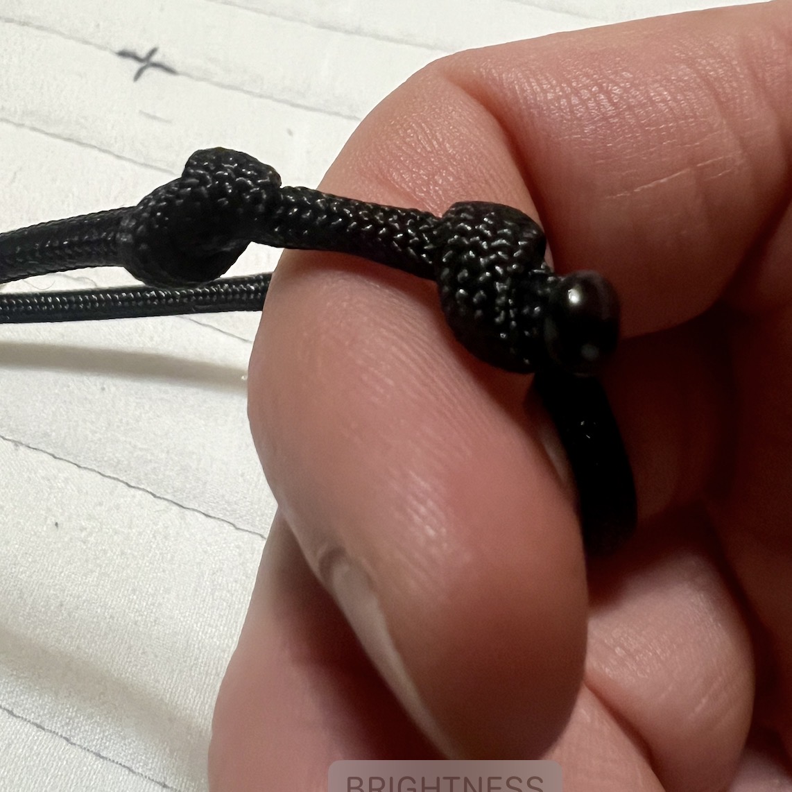

Myself, I tie not one, but two overhand knots on the release cord. My two knots are separated by 0.50” and bracket the front/back of the side of my index finger. Gives precise location when holding the release cord and also feels more solid so can hold the cord more lightly.

Reply #1 - Jun 21st, 2026 at 10:30pm
Here is pic of my release knots.

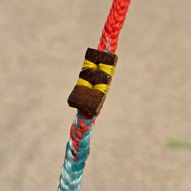

I'm pretty well stuck on the acro tab myself. @swiftcreek have you tried a simple leather tab like this on any of your slings? How does it compare to your grip/loop system?

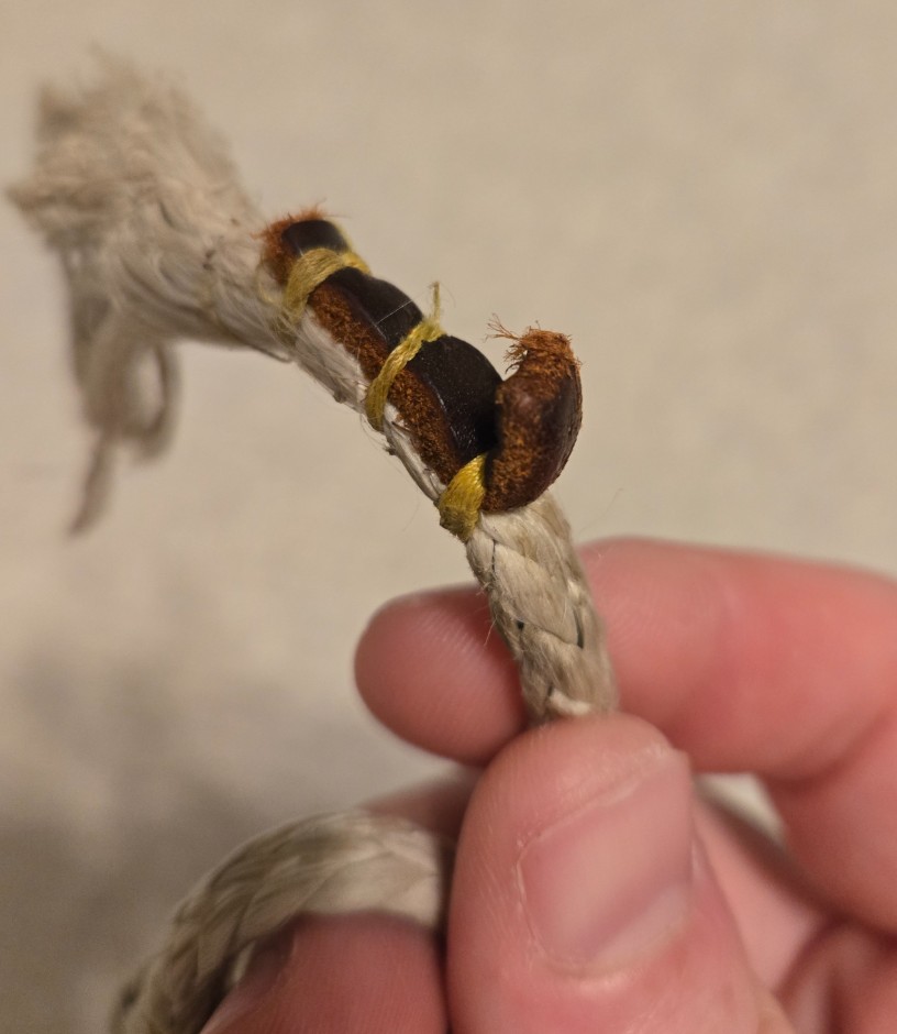

Reply #6 - Jun 22nd, 2026 at 8:59pm
bandit111964 wrote on Jun 22nd, 2026 at 5:16pm:
For release cords that are woven, is the acro tab considered the best?
As with most things in slinging, it's very subjective. Most people who use them love them. But there are plenty of excellent slingers who don't use them.
Does the leather wear out and need replacing frequently?
Nope, almost never. The photo below is one that has 24k throws on it and is showing no signs of giving up the ghost soon. And I'm using cheap polyester thread I just had laying around the house so I'm sure you could even do a lot better than that.
Has anyone placed an acro tab on a single strand paracord release cord (seatbelt sling for example)?
Yep, works just as well there. I've primarily used it on braided slings and dyneema, but any type of cord works great. Just make sure you have it aligned correctly when you sew it in place so you don't end up with twist in your cord when holding it(the tab goes under your thumb).
how do you know where to grip the release cord without a knot?  Do you have to load ammo and measure your grip each throw?
Basically yes - although it becomes an incredibly fast and natural motion once you get a feel for it after a few throws. If you're thinking it slows you down, it doesn't.

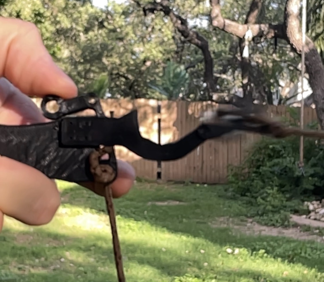

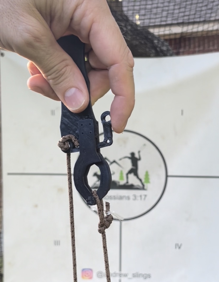

A simple overhand knot has always been perfectly acceptable for me… but just for fun, I just 3d printed a quick release… or I suppose you could call it the world’s smallest staff sling 😆
It’s super fast! …so fast that I feel like I forgot how to sling when I use it. I keep releasing the shot way too early and have no power whatsoever, but I’m tempted to try retraining my brain until I can actually hit a target with it.

Re: Any unique release ideas?
Reply #11 - Jun 24th, 2026 at 10:41am
Whoaaa, very cool! I've thought about doing something like this for a while, just never went to the trouble of designing it.
I would be interested to see some longer-term practice with it to see if it does result in improved consistency compared to a standard release.
Very interesting that your instinct gives you an early release with it - that indicates a standard release with a knot or tab has significant delay involved? I would have expected some change, but I would not have thought it would be terribly different between the two in terms of timing, moreso in consistency.
Side-note: you should cross-post to youtube shorts! I'd love to see your content more often, but I'm not on instagram. I believe there are tools out there to do this automatically when you post to one or the other.
Posts: 3069
Reply #12 - Jun 25th, 2026 at 6:36pm
I haven’t fully analyzed the high speed yet, but for a rough order of magnitude on a linen balearic, I measured about a 50ms release time (from the moment the cord starts slipping until it disconnects from the hand). I am getting something around 10ms for a disconnect on the quick release clip. If those rough numbers are correct, then the quick release is 5x faster.
Reply #13 - Jun 25th, 2026 at 9:09pm
Whoa! Yeah that'll do it. Crazy!
Reply #14 - Jun 25th, 2026 at 10:19pm
Is the 3d printed quick release spring loaded??
Is that why it is so fast?
If it is spring loaded is the spring a linear spring or a torsion spring?
