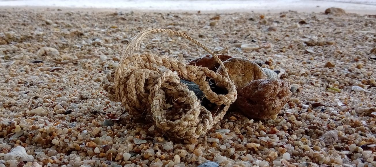

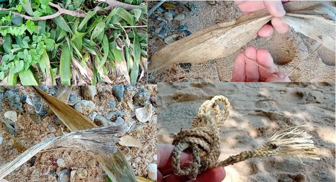

Mattias, it was not possible to make a sling out of an Epaulette. But I made it from wild Yucca leaves and Coconut fibers. I really enjoyed weaving Yucca leaves. The sling turned out to be very tough and sturdy. Try to weave, even if it doesn't work out the first time to make a good sling, but you will get invaluable practical experience, and no amount of money can buy it.

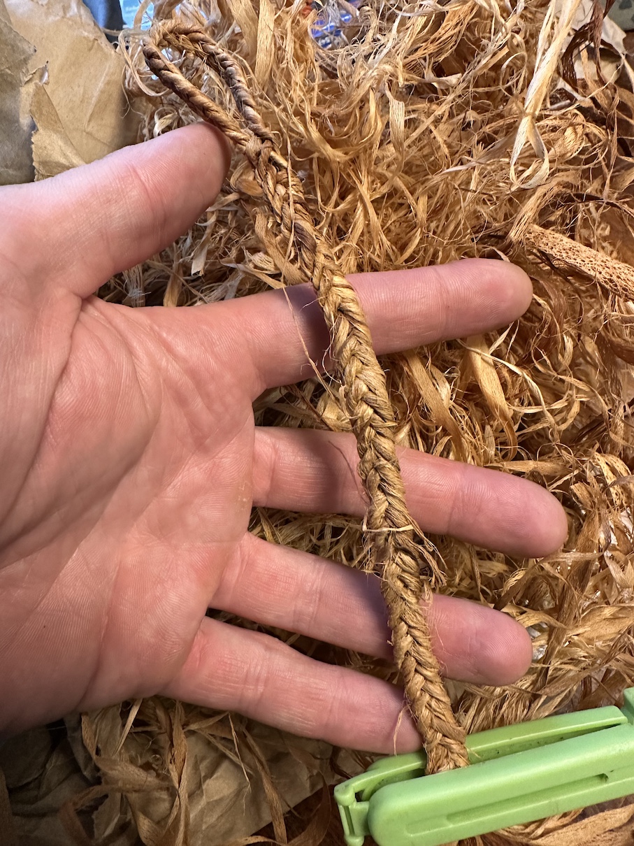

At the moment I‘m braiding my first „authentic“ sling from linden tree bark. I‘ll show you a picture of the status quo.
But I saw a very good tutorial of how to braid a balearic sling on YT and it says, that Esparto is very perfect for it, so that’s why I‘m asking.
I will also try horse hair 🙂
Best regards, Matthias

I like the natural color of your lime bast. We have a lot of lime trees growing, we will need to weave one too. I think if you comb it properly, you can get strong and fine fibers.
