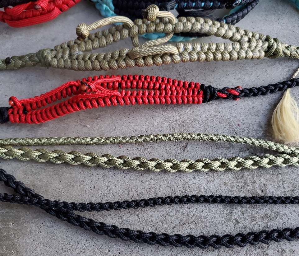

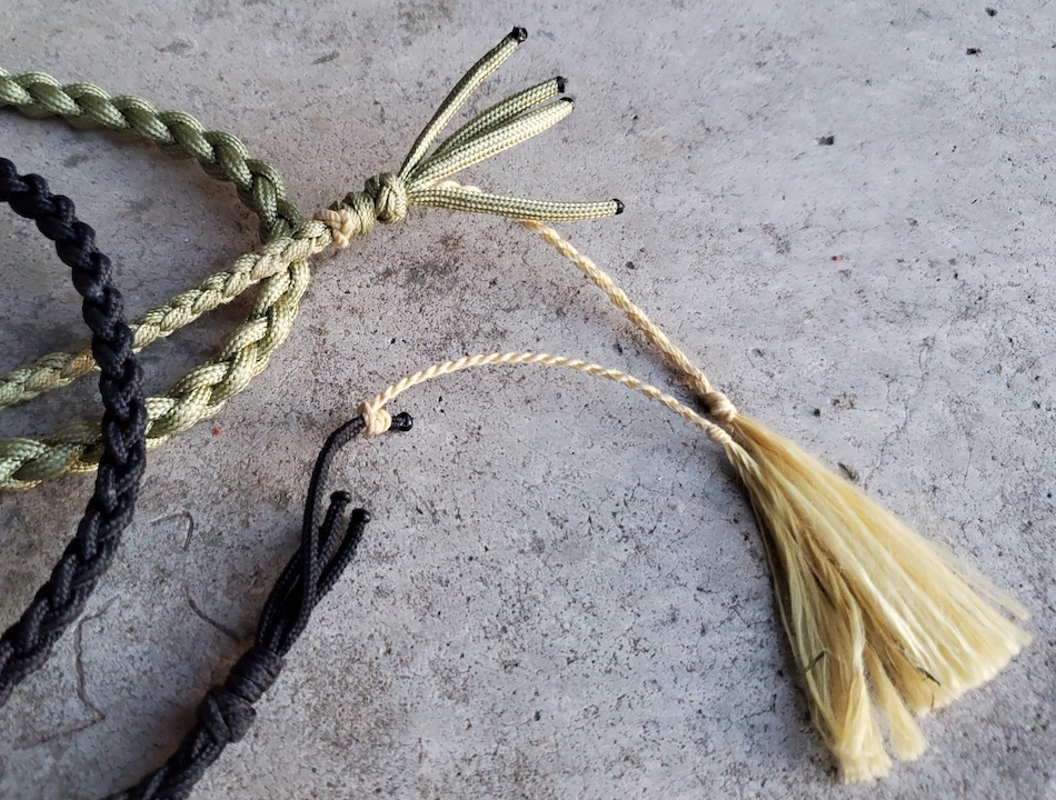

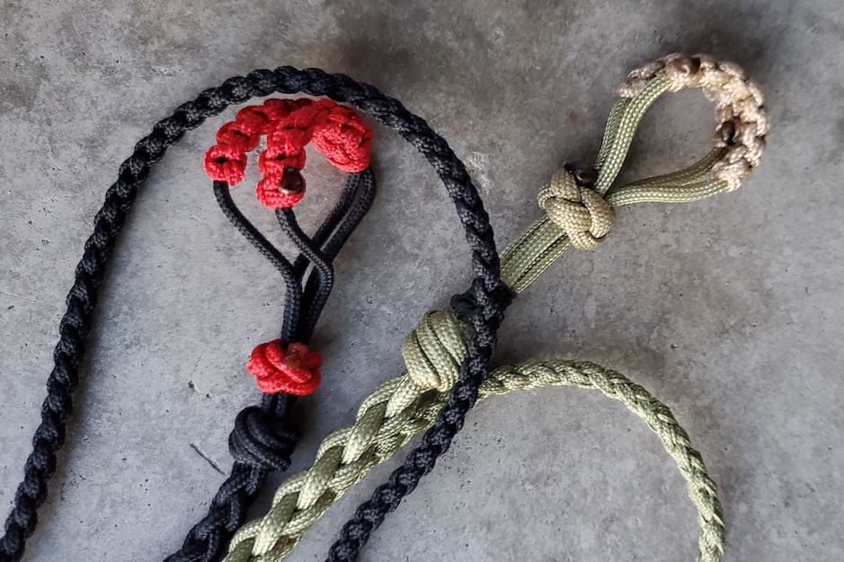

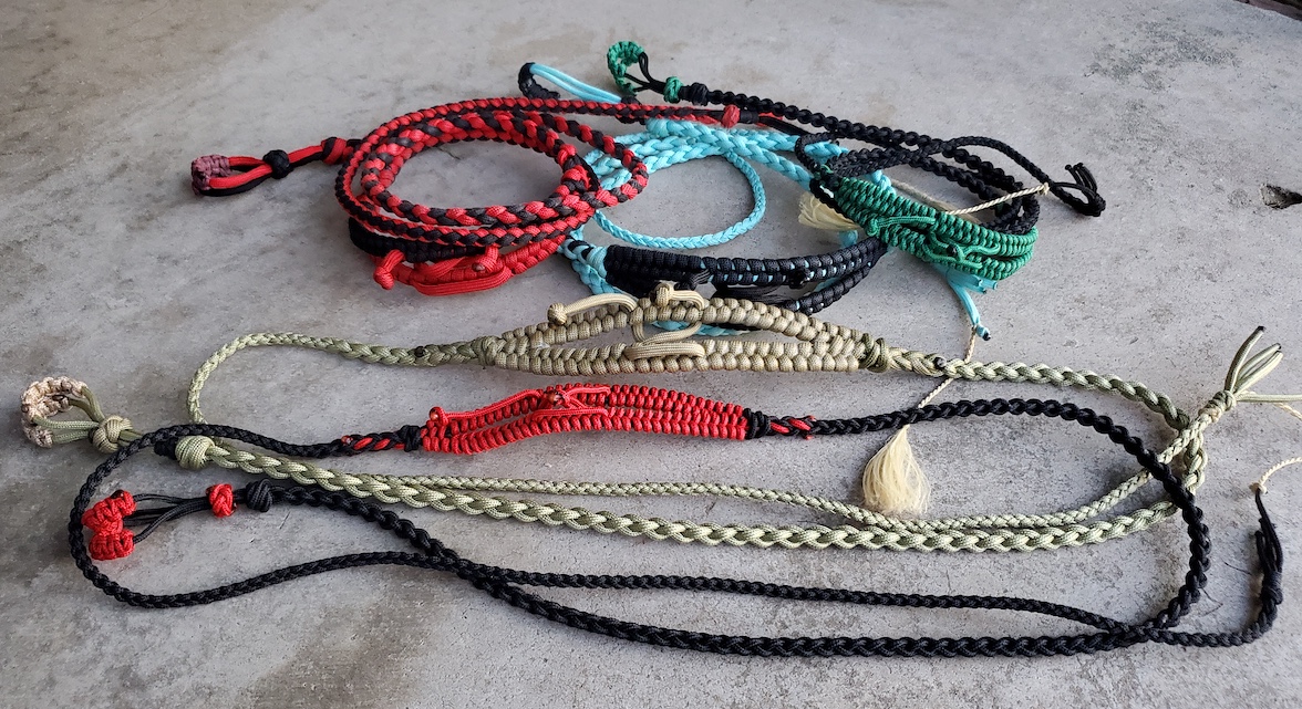

Maker: Practical Paracord
Shop: https://www.practicalparacord.com
Models: Smiling Sling & Slim Sling
Material: Paracord
Length: 24 and 30 inches (most common, but others are available)
Weight: ~30-60 grams (depending on model and length)
I don't think this one needs much of an introduction.  I can't actually say if this is the OG braided paracord sling, but if not it definitely put them on the map.
Now there's plenty of tutorials out there on braided paracord slings.  But a lot of them use techniques that Channing brought to the table.  His slings also work really well.  The guy takes trophies home from Ibiza every year using them.  My favorite is still his first model that had a thinner release cord.  It's in the back left in the photo with all of them.  The slings he makes now have an even thinner release cord (which you can see in the pics).  To me they feel like a braided sling when you're rotating, but like a single strand sling when you release.  They're really fast!  He also puts a coating (of something I forget) on the pouch for protection to extend the life.
These slings are in the category of 'most of us could probably make that pretty easily'.  But if you're just starting out, it's a great option.  Or if you're an established slinger but don't feel like making one!  And I'm pointing at myself with that comment.  I've probably bought at least 10 slings from Channing over the years.  And still using them.  My favorite sling for ice balls!  Or if I'm trying out a new braided sling and can't quite get the feel for it, my fall back is almost always a Practical Paracord.  In my opinion they're just a classic, and everyone should have at least one.
