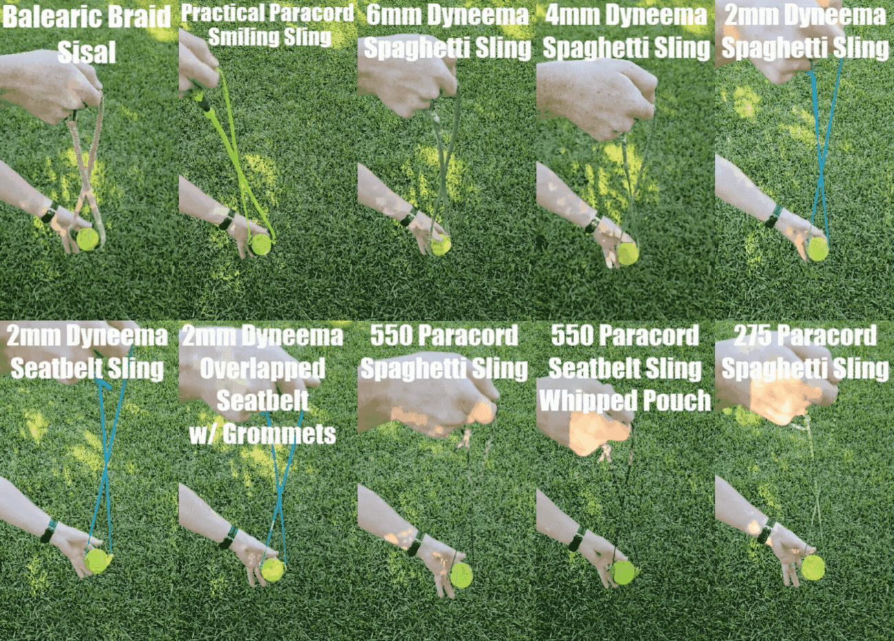

Since I've recently experimented creating slings with a bunch of different cord and pouch materials, I decided I should do a direct comparison of the effect of torsion on all of those different material combinations.
For anyone not familiar with this concept, I would highly recommend watching Acroballistics video on it: https://www.youtube.com/watch?v=vOuRwrfA7GQ
TL;DR you generally want more resistance against torsion so that you have more control over release angle and so that the cords don't tangle while the sling rotates.
So I took videos of a bunch of different cord and pouch materials to see how they compare and synced them side-by-side into the same frame. See the gifs at the bottom for the final results!
I froze the frame for each sling once it stabilized, so the gifs overall are as long as the longest sling took to stabilize. Also, I didn't realize how badly the grass background was going to interfere until after I had taken all the footage, sorry about that. They're also hosted on my home server(too big for giphy), so they may load a little slowly.
The basic methodology was to put a tennis ball and a baseball into each sling, rotate it 180 degrees so there is a single twist in the cords, then simply let go. Both are standard sizes and weights: 56g for the tennis ball and 143g for the baseball. All slings are about the same length, 28 inches give or take an inch. Retention loop was on my ring finger for these tests(more on that below).
Here are the different types of slings involved. I made variations of most with 6mm, 4mm and 2mm dyneema as well as 550, 275 and 90 paracord.
  • Traditional balearic braided sisal
  • Practical Paracord Smiling Sling (custom braid design of a few types of paracord)
  • 2-inch webbing seatbelt slings with a nail knot transition to the cords, which makes for a very stiff pouch transition (see Mersa's build video here: https://www.youtube.com/watch?v=-EBfUItUJFM)
  • 1-inch webbing overlapped pouch seatbelt sling with grommets connection to the cords instead of the nail knot, which makes for a much more flexible pouch transition
  • Spaghetti Slings - I'm using this as a general term for my two similar sling designs that use one continuous cord with a pouch made of the same cord so there is little or no pouch transition. Spliced dyneema version here and paracord version with sheet bends here.
A couple of these are essentially duplicates because I wanted to see if the pouch or pouch connection(nail knot seatbelt vs grommets vs sheet bend vs dyneema splice) had much of an effect; it didn't.
Some notes on the results:
  • As expected, both braided slings performed very well.
  • Sisal settles super fast and almost hit my fingers as I was releasing the twist. There is a very small amount of kickback from the untwist before it settles.
  • The smiling sling settles in nearly the same amount of time as the sisal, but overall a little more slowly, so it didn't have any kickback it needed to recover from.
  • 2mm dyneema settles in about the same time as 550 paracord(which is 4mm diameter) at about a third the weight.
  • 275 paracord is 2mm in diameter as well, but performs much worse than 2mm dyneema.
  • Dyneema that has been rolled flat doesn't seem to perform any differently than stock round dyneema.
And some subjective notes about using the slings:
  • With balearic-style windup and throw, I couldn't get 2mm dyneema to tangle with a baseball, which was a little surprising to me. Although as I noted above, I keep the retention loop on my ring finger. With the retention loop on my middle finger, there was some tangling starting to happen with the baseball and the 2mm dyneema. Although for exactly this reason, I wouldn't recommend using your middle finger for single-strand slings - use your ring or pinky. They're simply too wobbly without enough distance between release and retention cords.
  • In about a thousand throws I've never had the 2mm dyneema on my ring finger tangle with a tennis ball, and I was able to get a very consistent rifle spiral release from the first few throws.
  • 275 paracord would tangle with a baseball quite easily even on my ring finger, and would just barely tangle with a tennis ball.
  • Anything above 275 did not tangle at all with either the tennis ball or baseball(on my ring finger).
  • On a somewhat related note, all paracord does have the problem of the internal cord getting permanently twisted relative to the outer sheath layer(over time) which will cause strange twisting and release problems even if it doesn't feel like it is tangling during windup. Primarily for this reason(although also for weight and durability) I would not recommend paracord at all for single-strand slings. Dyneema is simply superior in every way.
Baseball:
Tennis Ball:

I did also test a 90 paracord spaghetti sling and the results were hilariously bad, so I'm including them separately here mostly just for giggles. Obviously this stuff tangles like crazy with nearly any projectile and is too thin and harsh on the fingers, but I wanted to test it anyway.
With this sling it looks like I'm pumping it to keep going forever, but I promise I was not. This stuff is just so thin that it keeps the rotation going nearly forever.
