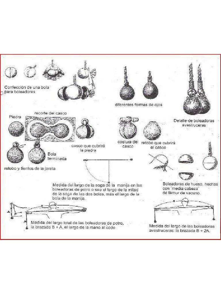

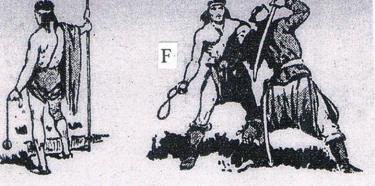

BOLAS - different types, making my own and need help please (Read 3279 times)
MapleMatt666
Posts: 16
BOLAS - different types, making my own and need help please
May 2nd, 2024 at 3:17pm
Hi guys, Id like to ask on various types of Bolas, maybe depending on localities in South America, different styles, different ways of making and materials used for such, also would like to try to make my own, as a first stuff ever.
I do not know, which tools would I need and what do would You recommend me to obtain or buy for such project. I do not want to go the simpliest way as I am not rushing, so it can be a longer term project, but want it really look good and authentic and maybe meanwhile for run make something out of paracord. Same thing, do not know what type of paracord do I need and the lenght of it etc.
Any knowledgable guys can help me out please? It is kind of a new hobby and I want to be good at it, so unsure, would be 50 USD enough for purschasing the material or do I need to add something up to it, I have low knowledge of this and will appreciate any kind of link on youtube or other experienced members advice, tips and tutorials.
If someone can go bit more indepth, I would extremely appreciate that. Thanks alot to everyone for helping me and wish You guys nice evening! With the products or either tools for making, please, try and be bit more specific
MapleMatt666
Posts: 16
Re: BOLAS - different types, making my own and need help please
Reply #1 - May 2nd, 2024 at 4:53pm
Im thinking of buying 100m paracord, its a 3 mm thin, is it good choice, or should I order different thickness or even different material for rope?
xud9a - call me zud 👍
Ringing Slocks !
Posts: 925
Nottinghamshire, England
Re: BOLAS - different types, making my own and need help please
Reply #2 - May 3rd, 2024 at 7:58am
Don't sweat it.
Take 3pieces of string.
Take 3 circles of cloth.
Put gravel in the cloth.
Tie them into bags.
Knot the strings together, whirl and throw.
Don't like it ?
Try different string, different cloth, different lengths, whirl and throw.
Better or worse than first ?
Learn by experimentation, using what you have before you waste money on something which may bring you no pleasure ... or become a life long hobby !
My outlook on life is Aristotalean; on seeing an Acorn I see a potential oak tree rather than Plato's view that it is a failed copy.
BE SAFE,    BE SMILEY,   BE STRANGE
MirkoSling
Marichiweu
Posts: 35
Re: BOLAS - different types, making my own and need help please
Reply #3 - Sep 14th, 2024 at 11:32pm
I made my own trying to mimic the boleadoras that Gauchos use in Argentina by using thicker cordage and tying them onto hooks that I screwed into leather wrapped wooden balls. I lost it a while ago but over all the process took very little time (bar the leather), probably 10 - 15 minutes in one sitting. For that style in particular I feel like the majority of the time spent is probably on adding designs and making it look pretty as opposed to actually making the weapon. I've even seen a video of someone using paracord and hex nuts as bolas and I imagine that takes even less time to make.
Overall I think Bolas are one of the simplest weapons to make as basically everything can be however you want it, the length of rope, thickness, weight of the stones don't really matter as long as its weights on the end of a string. If you do want some guidance on length of string, while researching I read that some Gauchos leave one of the strings a bit longer than the other two, and that this is the one you hold as you swing it above your head. I made the two other ropes the length of my palm to my collarbone so they were pretty long and worked pretty well. In terms of weight as long as its not extremely light it should work fine, I even made some of tennis balls to throw at my friends.
TOMBELAINE
Posts: 839
france
Re: BOLAS - different types, making my own and need help please
Reply #4 - Sep 16th, 2024 at 7:55am
If you don't know this website, a good beginning.
https://www.bing.com/videos/riverview/relatedvideo?q=lancer+des+bolas&mid=BDFE16...
After if you take pleasure, you can make historical bolas or others.
Sassa
Posts: 11
United Kingdom
Re: BOLAS - different types, making my own and need help please
Reply #5 - Aug 30th, 2025 at 7:07am
I made them in the past with 550 paracord and tennis balls for practice and did not go so well  looking at "Esgrima Criolla" on YouTube I learned what I was doing wrong and made another from thicker cordage like the one used by three surgeons 1/2" approx and snooker balls I bought from a charity shop I also learned that the  length of the main rope define the max distance of reach basically long ropes for open spaces short for area with considerable vegetation so to avoid tangles around trees It is made with 2 length of rope not 3 one long and a short called "manija"(T shaped)  that slides on the main one and act as handle to spin and release the position were it slides determine the reach acting almost like a rear site Here the link
https://www.youtube.com/watch?v=TYZhZC-59kY
thabaill
Posts: 172
Re: BOLAS - different types, making my own and need help please
Reply #6 - Oct 1st, 2026 at 4:57pm
« Last Edit: Oct 1st, 2026 at 6:28pm by thabaill »
thabaill
Posts: 172
Re: BOLAS - different types, making my own and need help please
Reply #7 - Oct 1st, 2026 at 4:58pm
Es destacable que las referencias etnohistóricas sobre sistemas tecnológicos prehispánicos se centran fundamentalmente en las boleadoras, tecnología que acaparó la atención de los europeos. Fernández de Oviedo ([1547] 1851:183) realiza la primera descripción detallada de estas armas:
    Tengo averiguado con muchos testigos de vista, que ciertos indios que en el Rio de la Plata se llaman guaranias usan çierta arma, y no todos los indios son hábiles para ella (.) la cual exercitan en la caça, para matar los venados, y con la misma mataban á los españoles, y desta forma. Toman una pelota redonda de un guijarro pelado, tamaño como el puño, é aquella piedra átanla a una cuerda de cabuya [cáñamo] y tan luenga como çinqüenta pasos é mas ó menos, é el otro cabo de la cuerda átanlo á la muñeca del braço derecho, en el cual traen revuelta la cuerda restante holgada, exçepto quatro o çinco palmos della, que con la piedra rodean é traen alrededor, como lo suelen haçer los fundibularios. Mas assi como el que tira con la honda, rodea el braço una o dos veçes antes que salga la piedra, estotros la mueven alrededor en el ayre con aquel cabo de la cuerda que está asida diez o doçe vueltas, para que con mas furiosidad é fuerça vaya la pelota : é cuando se suelta, en el instante extiende el indio el braço, porque la cuerda salga libremente, descogiéndose sin algún estorbo. E tiran tan cierto (.) é dan adonde quieren á çinqüenta pasos é mas é menos, hasta donde puede bastar la traylla : e en dando el golpe, va con tal arte guiada la piedra, que assi como ha herido da muchas vueltas la cuerda al hombre o caballo que hiere , é trabasse con él de manera en torno de la persona ó bestia á quien toco, que con poco que tira el que tiene la cuerda atada al braço, da en el suelo con el hombre ó caballo, á quien ha herido; y assi acaban de matar al que derriban, muy á salvo del caçador ó mílite que tal arma usa.
La importancia de esta descripción reside en que aborda los diferentes componentes de estas armas así como los gestos técnicos involucrados en su utilización; además, proporciona algunos datos sobre la manufactura de las bolas y sobre los diversos contextos de uso. Esta arma habría estado compuesta de una única bola de piedra atada a una cuerda de cáñamo de aproximadamente 70 m de largo (50 pasos), que era asida a la muñeca en el otro extremo y enrollada en el brazo, dejando un tramo para revolear e impulsar la bola. El lanzamiento se producía con el brazo extendido para que la cuerda se desenrolle con facilidad. En cuanto a la manufactura de las bolas, señala que eran confeccionadas a partir de nódulos descortezados que adquirirían una forma esférica del tamaño de un puño. También se desprende a partir de este pasaje que el manejo de esta arma era complejo e implicaba la adquisición de una destreza técnica a través de la práctica y la experiencia. Por este motivo, su uso no era generalizado hacia el interior del grupo, sino que solo algunos individuos poseían la experiencia, práctica y habilidad necesarias para su lanzamiento. De hecho, numerosos europeos intentaron sin éxito utilizarlas: "en tanto número de chripstianos como fueron á aquella tierra, habiendo muchos dellos sueltos y mañosos, ninguno supo tirar aquellas piedras, segund los indios, aunque infnitas veçes muchos españoles lo probaron" (Fernández de Oviedo y Valdés [1547] 1851:184). Asimismo, es interesante mencionar que la descripción de Fernández de Oviedo se corresponde con la modalidad de uso de boleadora de una bola asida con una "traylla" y no a la modalidad "pendientes de una cuerda", que podría corresponder al sistema de dos o tres bolas unidas con tientos que se describe en crónicas posteriores. Por último, es necesario aclarar que, si bien este pasaje no hace referencia explícita a la ubicación geográfica de los grupos sociales a los que adjudica el uso de la boleadora, el autor menciona en otro lugar que los españoles sufrieron ataques con estas armas hacia el interior del territorio: "estos [tripulantes] de don Pedro probaron con su daño la tierra adentro y en especial en la manera de çierta arma ofensiva que en aquella tierra usan los indios" (Fernández de Oviedo y Valdés [1547] 1851:183).
https://www.scielo.org.ar/scielo.php?script=sci_arttext&pid=S1852-14792016000200...
thabaill
Posts: 172
Re: BOLAS - different types, making my own and need help please
Reply #8 - Oct 1st, 2026 at 5:10pm
thabaill wrote on Oct 1st, 2026 at 4:58pm:
Es destacable que las referencias etnohistóricas sobre sistemas tecnológicos prehispánicos se centran fundamentalmente en las boleadoras, tecnología que acaparó la atención de los europeos. Fernández de Oviedo ([1547] 1851:183) realiza la primera descripción detallada de estas armas:
    Tengo averiguado con muchos testigos de vista, que ciertos indios que en el Rio de la Plata se llaman guaranias usan çierta arma, y no todos los indios son hábiles para ella (.) la cual exercitan en la caça, para matar los venados, y con la misma mataban á los españoles, y desta forma. Toman una pelota redonda de un guijarro pelado, tamaño como el puño, é aquella piedra átanla a una cuerda de cabuya [cáñamo] y tan luenga como çinqüenta pasos é mas ó menos, é el otro cabo de la cuerda átanlo á la muñeca del braço derecho, en el cual traen revuelta la cuerda restante holgada, exçepto quatro o çinco palmos della, que con la piedra rodean é traen alrededor, como lo suelen haçer los fundibularios. Mas assi como el que tira con la honda, rodea el braço una o dos veçes antes que salga la piedra, estotros la mueven alrededor en el ayre con aquel cabo de la cuerda que está asida diez o doçe vueltas, para que con mas furiosidad é fuerça vaya la pelota : é cuando se suelta, en el instante extiende el indio el braço, porque la cuerda salga libremente, descogiéndose sin algún estorbo. E tiran tan cierto (.) é dan adonde quieren á çinqüenta pasos é mas é menos, hasta donde puede bastar la traylla : e en dando el golpe, va con tal arte guiada la piedra, que assi como ha herido da muchas vueltas la cuerda al hombre o caballo que hiere , é trabasse con él de manera en torno de la persona ó bestia á quien toco, que con poco que tira el que tiene la cuerda atada al braço, da en el suelo con el hombre ó caballo, á quien ha herido; y assi acaban de matar al que derriban, muy á salvo del caçador ó mílite que tal arma usa.
La importancia de esta descripción reside en que aborda los diferentes componentes de estas armas así como los gestos técnicos involucrados en su utilización; además, proporciona algunos datos sobre la manufactura de las bolas y sobre los diversos contextos de uso. Esta arma habría estado compuesta de una única bola de piedra atada a una cuerda de cáñamo de aproximadamente 70 m de largo (50 pasos), que era asida a la muñeca en el otro extremo y enrollada en el brazo, dejando un tramo para revolear e impulsar la bola. El lanzamiento se producía con el brazo extendido para que la cuerda se desenrolle con facilidad. En cuanto a la manufactura de las bolas, señala que eran confeccionadas a partir de nódulos descortezados que adquirirían una forma esférica del tamaño de un puño. También se desprende a partir de este pasaje que el manejo de esta arma era complejo e implicaba la adquisición de una destreza técnica a través de la práctica y la experiencia. Por este motivo, su uso no era generalizado hacia el interior del grupo, sino que solo algunos individuos poseían la experiencia, práctica y habilidad necesarias para su lanzamiento. De hecho, numerosos europeos intentaron sin éxito utilizarlas: "en tanto número de chripstianos como fueron á aquella tierra, habiendo muchos dellos sueltos y mañosos, ninguno supo tirar aquellas piedras, segund los indios, aunque infnitas veçes muchos españoles lo probaron" (Fernández de Oviedo y Valdés [1547] 1851:184). Asimismo, es interesante mencionar que la descripción de Fernández de Oviedo se corresponde con la modalidad de uso de boleadora de una bola asida con una "traylla" y no a la modalidad "pendientes de una cuerda", que podría corresponder al sistema de dos o tres bolas unidas con tientos que se describe en crónicas posteriores. Por último, es necesario aclarar que, si bien este pasaje no hace referencia explícita a la ubicación geográfica de los grupos sociales a los que adjudica el uso de la boleadora, el autor menciona en otro lugar que los españoles sufrieron ataques con estas armas hacia el interior del territorio: "estos [tripulantes] de don Pedro probaron con su daño la tierra adentro y en especial en la manera de çierta arma ofensiva que en aquella tierra usan los indios" (Fernández de Oviedo y Valdés [1547] 1851:183).
https://www.scielo.org.ar/scielo.php?script=sci_arttext&pid=S1852-14792016000200...
It is noteworthy that ethnohistorical references regarding pre-Hispanic technological systems focus primarily on the *boleadoras*—a technology that captured the attention of Europeans. Fernández de Oviedo ([1547] 1851:183) provides the first detailed description of these weapons:
I have ascertained from many eyewitnesses that certain Indians in the Río de la Plata region—known as Guaraníes—use a particular weapon (though not all of them are skilled in its use). They employ it for hunting deer, and they used the same weapon to kill Spaniards in the following manner: They take a round, smooth stone the size of a fist and tie it to a hemp rope some fifty paces long—more or less—attaching the other end to their right wrist. They keep the remaining length of rope loosely coiled around that arm, leaving only four or five spans free—the section holding the stone—which they swing around in a circle, much like a slinger. However, whereas a slinger swings his arm once or twice before releasing the stone, these men whirl the stone through the air ten or twelve times to give the projectile greater speed and force. Upon release, the Indian instantly extends his arm so the rope can uncoil freely without obstruction. Their aim is remarkably accurate; they can strike a target at a distance of fifty paces—more or less, depending on the rope's length. Upon impact, the stone is guided with such skill that, immediately after striking, the rope wraps itself repeatedly around the victim—whether man or horse—entangling the person or beast so effectively that a slight tug from the thrower brings the wounded man or horse crashing to the ground. And thus they finish off the one they have brought down, remaining quite safe from the hunter or soldier who wields such a weapon.
The significance of this description lies in its coverage of the weapon's various components and the technical movements involved in its use; it also provides details regarding the manufacture of the stone balls and the diverse contexts in which they were employed. The weapon appears to have consisted of a single stone ball attached to a hemp cord approximately 70 meters (50 paces) long; the other end was secured to the wrist and the cord wrapped around the arm, leaving a length free to swing and propel the ball. The throw was executed with the arm extended to allow the cord to unwind easily. Regarding the manufacture of the balls, the account notes that they were fashioned from decorticated nodules, shaped into spheres roughly the size of a fist. The passage also implies that handling this weapon was complex, requiring the acquisition of technical proficiency through practice and experience. Consequently, its use was not widespread within the group; only a select few individuals possessed the necessary experience, practice, and skill to throw it. Indeed, numerous Europeans attempted to use them without success: "of the many Christians who went to that land—including many who were agile and dexterous—none knew how to throw those stones as the Indians did, even though many Spaniards tried countless times" (Fernández de Oviedo y Valdés [1547] 1851:184). It is also worth noting that Fernández de Oviedo’s description corresponds to the use of a single-ball *boleadora* attached to a tether (*traylla*), rather than the "suspended from a cord" style—which likely refers to the system of two or three balls joined by leather thongs described in later chronicles. Finally, it should be clarified that, although this passage does not explicitly refer to the geographical location of the social groups associated with the use of the *boleadora*, the author mentions elsewhere that the Spanish suffered attacks with these weapons further inland: "these men [crew members] of Don Pedro experienced the interior of the land to their own detriment, particularly regarding a certain offensive weapon used by the Indians of that region" (Fernández de Oviedo y Valdés [1547] 1851:183).
thabaill
Posts: 172
Re: BOLAS - different types, making my own and need help please
Reply #9 - Oct 1st, 2026 at 5:35pm
There was also a similar but different weapon called "bola perdida" (lost ball) or "bola loca" (crazy ball).
La “bola perdida”, antecesora y también contemporánea de las “boleadoras”, ya sea las llamadas “ñanduceras” que tienen dos bolas o las “potreras” que tiene tres, la “bola perdida”, fue una de las primeras armas arrojadizas utilizadas por nuestros aborígenes.
Estaba hecha con una bola de piedra, sujeta por un ramal de cuero, nervios o tendones de diversos animales, de poco más de un metro de largo y que abatía a la pieza por percusión.
Es decir, mataba el golpe que producía esa piedra en alguna parte vital de la misma. Era calificada como “perdida”, debido a que como era muy fácil tanto confeccionarla, como encontrar los elementos que la componían, los indios nunca se preocupaban por recuperarla, ya que una vez arrojada, era muy difícil encontrarla caída en medio de esos infernales pajonales que cubrían nuestras llanuras.
Por tal razón, era común ver a  los cazadores y a los guerreros de un malón, partir, llevando atadas a su cintura, diez, doce y hasta quince de esas bolas.
El primero que menciona este tipo de arma es ULRICO SCHMIDT, cronista de la expedición de PEDRO DE MENDOZA, aunque su descripción de la misma, hace pensar que lo que vio en realidad en acción, fueron “boleadoras·” de tres bolas, pues decía que con ellas volteaban una animal y eso, con las bolas perdidas, les era imposible lograr. A estas boleadora de tres bolas, los gauchos las llamaban “las tres Marías”
https://elarcondelahistoria.com/bola-perdida/
The "bola perdida"—a precursor to and contemporary of the *boleadoras* (whether the two-ball *ñanduceras* or the three-ball *potreras*)—was one of the first throwing weapons used by our indigenous peoples.
It consisted of a stone ball attached to a cord—made of leather strips or animal sinews or tendons—measuring just over a meter in length; it brought down the prey through the force of impact.
In other words, the kill was achieved by the blow the stone delivered to a vital part of the animal. It was known as a "lost" weapon because, given how easy it was to fashion and to source its component materials, the Indians never bothered to retrieve it; once thrown, it was extremely difficult to locate amidst the hellish tall-grass thickets that blanketed our plains.
For this reason, it was common to see hunters—or warriors setting out on a raid—carrying ten, twelve, or even fifteen of these balls tied around their waists.
The first person to mention this type of weapon was Ulrich Schmidt, a chronicler of the Pedro de Mendoza expedition; however, his description suggests that the weapon he actually saw in action was the three-ball *boleadora*, as he noted that they could topple an animal with them—a feat impossible to achieve with the single "lost" ball. Gauchos referred to these three-ball *boleadoras* as "Las Tres Marías" (The Three Marys).
(Moderators: David Morningstar, Masiakasaurus, Mauro Fiorentini, Chris, Bill Skinner, Rat Man, Curious Aardvark)
