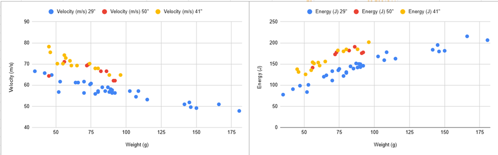

Here's some of my data from today. I did the 29" first to warm up, then switched to the 50". I felt like I wasn't snappy enough, so I went down to a 41" and was getting as good if not better velocities. Even had one over 200J (96g, 64.8 m/s) which is solid for myself.
Also, knowing that Jurek was hitting probably close to 80 m/s with 90g lead glands to hit his 505m throw is CRAZY!.
Even if it was 75 m/s ...still crazy.
Update: Added a few more data points from another day with the 41" and 29".
