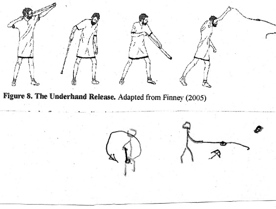

You can try this method. This is my idea of the underarm style. I can throw with it to 100 meters.
It's the wrist that turns, not the arm. At the drop, release the retaining line at the beginning of the ascent with your arm horizontal.
Like the tapestry of Bayeux if you want an historical example.
Re: Slinging with bad shoulder
Reply #18 - Jul 16th, 2022 at 2:53pm
That's exactly the drawing I was thinking of ! That final picture always seemed to me the epitome of mechanical ineffectiveness, with that uplifted, forced shoulder. Can you really make it work so well for yourself ?

It always seemed to me mechanically inefficient. This was striklngly illustrated by an archaeological article on slinging and hillforts, where a series of drawings broke down the movement (the drawings showed a bearded man, presumably the author, in a sort of tunic). The end movement and release, with a sort of raised shoulder and hopeful upwards movement of the whole body on tiptoes, were familiar to me from experimentation, and particularly reminded me of how weak the form is at converting body movement into forward release and speed. I seem to remember the underarm form used by other specialists (Thom Richardson), with bad results. The idea that this would have been used historically struck me as unlikely. In contrast, helicopter, sidearm, and fig-8 all converge into effective release in the final stage. They are all attested historically and ethnographically. Is there any evidence at all for underarm being used in such contexts ?
I also find timing of release more problematic with underarm often resulting in ridiculous upwards shots, difficult to adjust. And I speak as someone whose shots aways drag left and high.
These two reasons (mechanical weakness; problematic release times) are why I don't sling underarm, preferring helo (before shoulder issues and in spite of slack issues), "Makron" (one rotation from body facing away), and now sidearm (vertical rotation(s) and side-release).
   Of course every slinger is different but I don't find Underarm to be mechanically weaker.  The reason why I don't get quite the distance from an Underarm shot is that the topspin associated with such a shot causes the projectile to drop rather than rise as does a shot with backspin on it.  I also don't have any problems with the release of an Underarm shot.  But slinging is a very individualized sport so to each their own.

Yes, that works, but that is not how Dr Finney slings, with his horrible shoulder lift. I call this style "Thierry le Bossu". We all know that it's the sling, not the arm, that does the work ! What you describe is a sort of relaxed sidearm, I have no problem with that.

My release isn't sidearm but it's really underarm.
Finney's style is his conception of underarm. Gesticulate the arm is not a good idea.

Good, hard and accurate underarm is done without using your shoulder in any significant way.
It's actually the best style to learn first, as it demonstrates what the sling can do with very little effort on the users part.
It's mainly wrist, with a little elbow, and like every other style, just another weapon in a slingers armoury.
