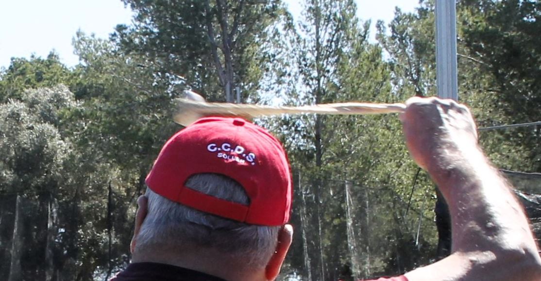

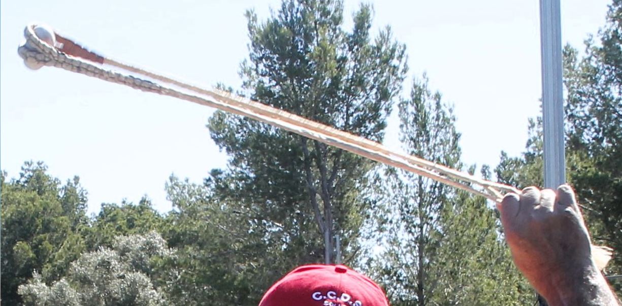

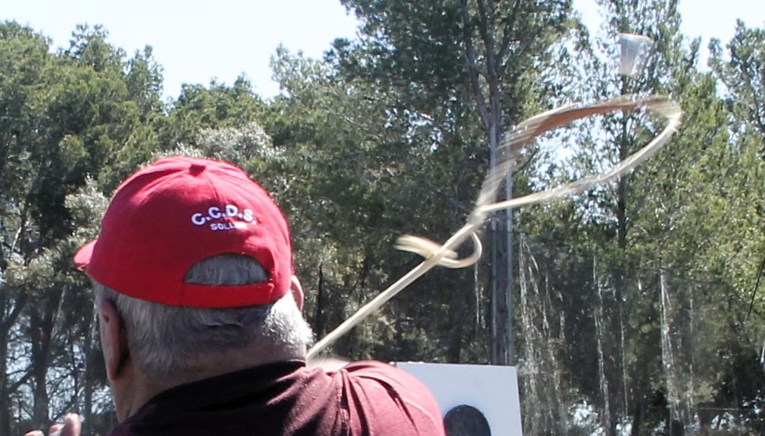

Problems of slingshot overflowing when throwing. What is the reason? In the photo, throwing with the index finger. It can be seen that everything is going well at first. But there is a swing and departure of the sling behind the back and then its twisting. In the third photo, you can see the overflowing of the sling and, as a result, the descent of the stone sharply upward and to the side. This is clearly visible in the freeze frame.  If Throwing occurs from the middle finger rather than the index finger, is the distance between the sling guides slightly greater and the probability of such an overrun may be less? But still, the main mistake of such descents, as it seems to me, is the loss of thrust and departure from optimal trajectories during a swing.
....I wonder what your opinion is about this twisting and sliding of the stone to the side.

Snow Serg wrote on May 27th, 2026 at 4:49am:
Have you seen this video? https://youtu.be/vOuRwrfA7GQ?si=NS6Dc2bP9kJYaye4
Perhaps this will help to understand the reason.

Reply #1495 - May 27th, 2026 at 8:51am
Pocket rock.et, Great video, thanks a lot!!
