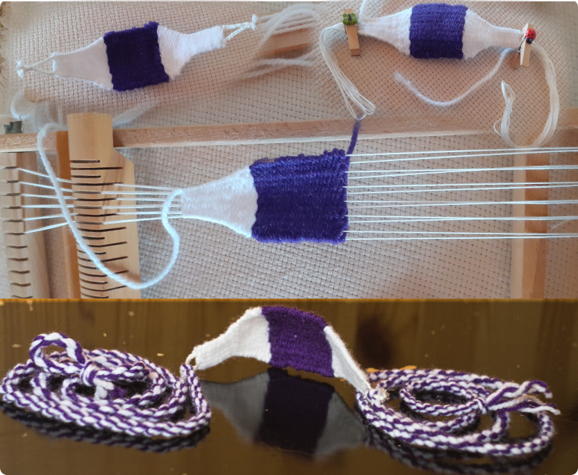

I just made my first (synthetic) wool sling with a woven pouch and twisted cords. The cords are exchangable and I twisted the release cord and the retention cord in different directions to minimize the twist of the sling when under load. Although the twisting against the twist of the wool is not the best thing to do, it came out ok.
The pouch is not woven like an egyptian one but "turned 90°". To the sides of the pouch I pulled a little more on the weaving wool and I layed some of the strings together (see picture).
I think that a nice split pouch could be made that way also.
The sling came out 35 inches (folded) and 9.9 grams (lighter than I thought). It is a little stretchy, but it works just fine.
What I found most surprising is how silent this sling is. Almost no sound at all.

Oh, wow! The twist with 2 colors looks really cool!
It's like my go-to sling but without the split in the pouch.

Beautiful job! Thumbs Up

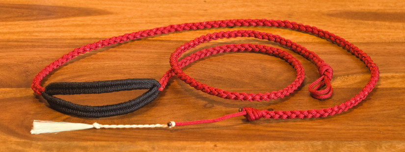

It was raining the last few days so it was not slinging time but sling building time. I tried this design for the first time. It is a 4 strand round braid with 425 paracord. The split pouch part is woven with 2 mm polyamide. The knots at the finger loop and the retention cord are simple overhand knots, so there is room for improvement there. The cracker is cevlar. The finger loops can be used on one finger or can be seperated.
The sling is 30 inches and weighs 49 grams. I think next time I will use 275 paracord to make it slimmer and lighter.
Posts: 1971
Reply #8060 - Sep 28th, 2025 at 10:58am
Looks very clean. I have a few braided paracord slings. They are heavier the release cord than I like. 275 would be better. Does polyamide have better abrasion resistance than other polymers?
Posts: 114
Reply #8061 - Sep 28th, 2025 at 2:28pm
IronGoober wrote on Sep 28th, 2025 at 10:58am:
I am not sure about that. The simple reason why I used it is because I wanted a black pouch and that string was what I had at hand. My understanding is, that it is the same material as paracord (Nylon/Polyamide).

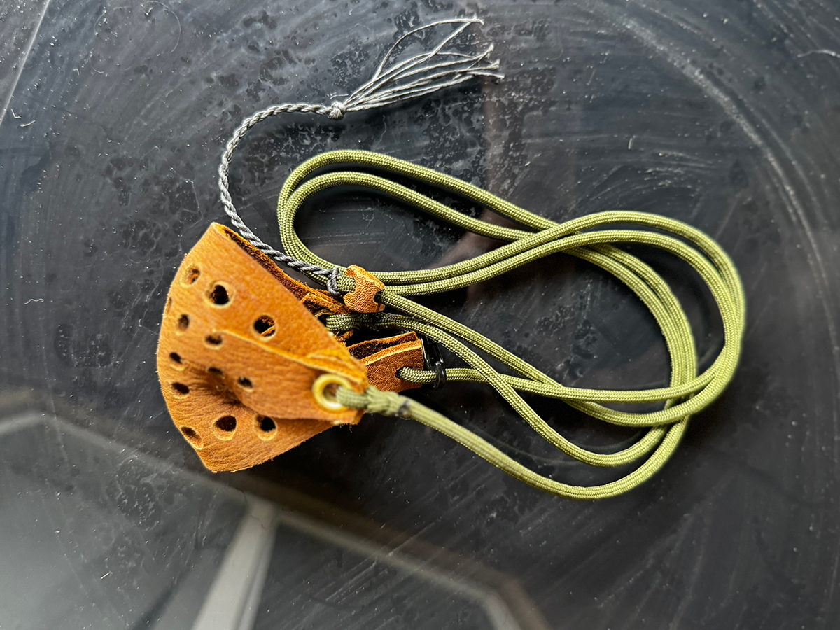

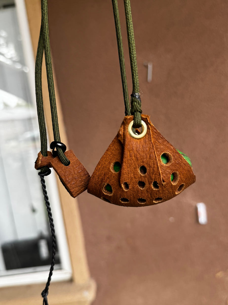

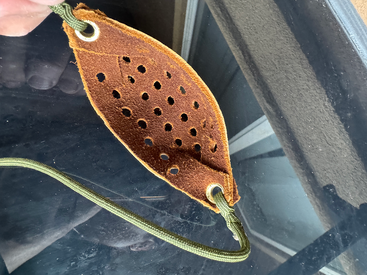

Pictures of my new sling on the Market called "The Giant Slayer" https://www.etsy.com/listing/4379152040/giant-slayer-leather-and-paracord

Looks likes some inspiration from Pan for a couple aspects.  I like that pouch design.  Looks good! Thumbs Up

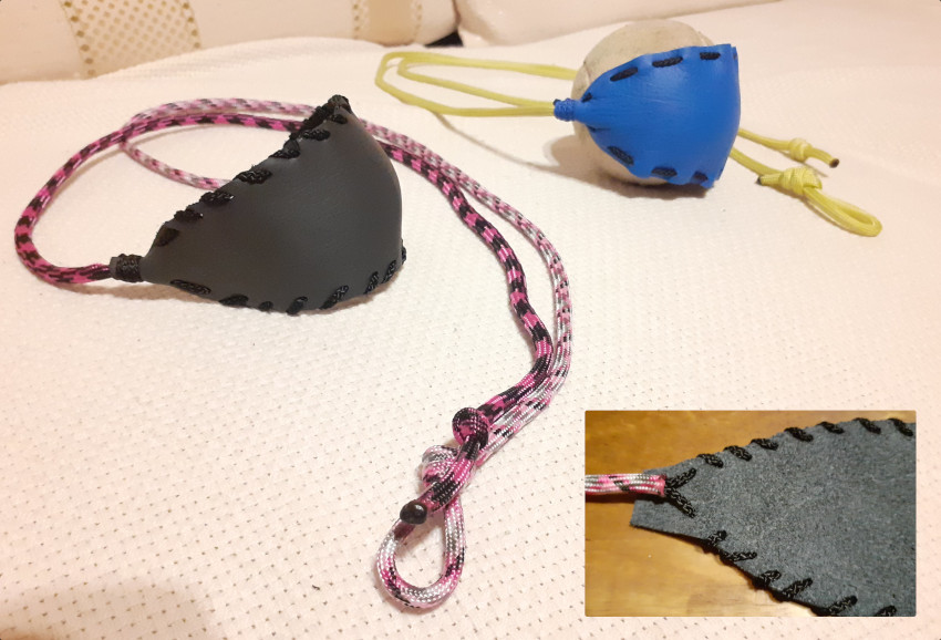

Here are two slings where I replaced the inner cords of the paracord with two thicker (2 mm) ones. So the two cords run through the whole sling. I was throwing a few tennis balls with those slings and it seems to work.
Posts: 3898
Reply #8067 - Oct 13th, 2025 at 10:36pm
Cool idea.  That makes for a nice transition into the pouch.

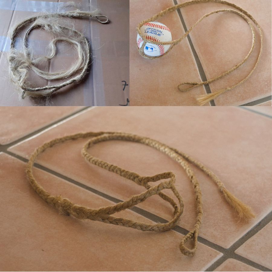

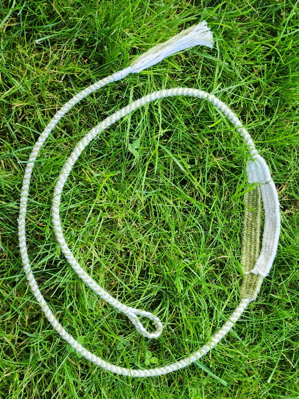

I made a 24 inch sling out of loose hemp fibers. It looks a bit rough because it was kind of a speed build. I want to use it for heavy rocks and I connected the two sides of the pouch with a bridge. It shoots really smoothly. I think I got the taper on the release cord just right this time. I have lighter slings that rip more on my finger than this one.
Posts: 1971
Reply #8069 - Oct 26th, 2025 at 12:54am
It looks like a boulder launcher! Good work.
