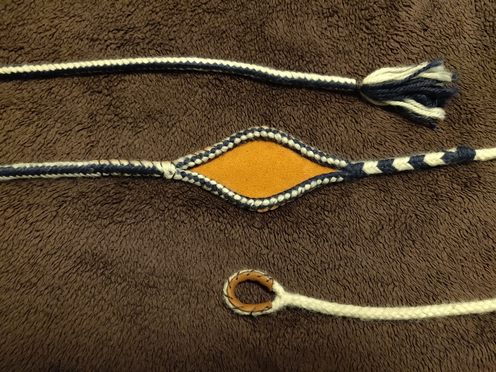

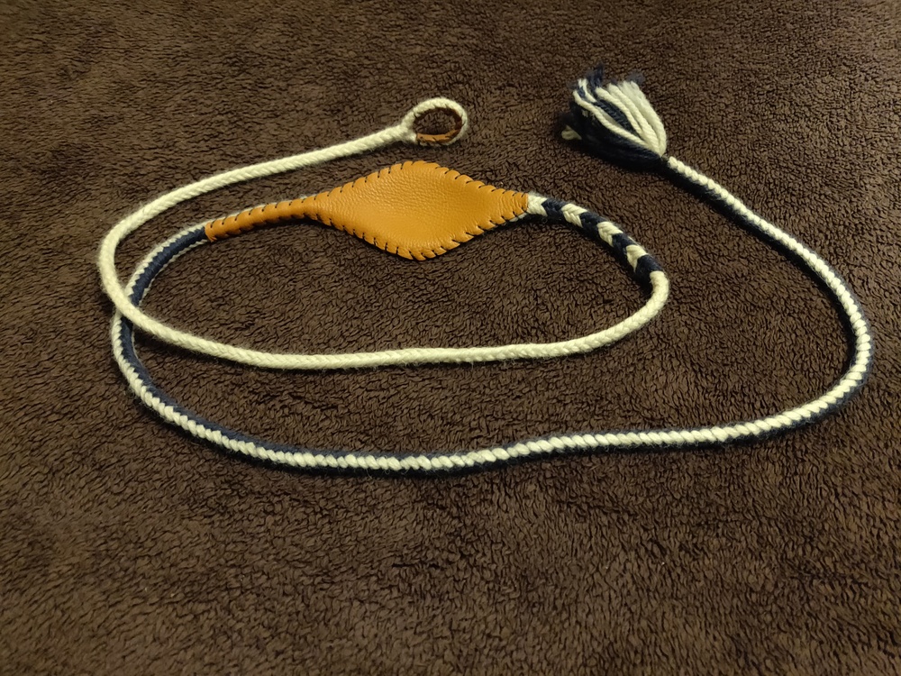

Braided wool apache sling with stitched leather pouch and fingerloop. 31'', soaked in hot water and dried under tension to remove stretch.

JudoP wrote on Dec 28th, 2020 at 12:16pm:
That's almost too pretty to use!
Reply #6294 - Dec 28th, 2020 at 2:25pm
Before I saw who posted the picture I thought, "Oh wow Hubert posted another sling, beautiful..."  That's a big compliment lol. Looks great man! What kind of leather did you use? I used to make and use apaches exactly like this, though perhaps not as nice,  and they work flawlessly.

Very nice slings. @Judo What braids did you use? They look great!
I haven't tested it yet, but I think a much more effective way of removing elasticity from wool is by either steaming it or by pouring hot water on it WHILE it is stretched. This makes it so that the the stretched wool fibers cannot relax back to their original state due to the change that the fibres undergo.

Thanks all for the kind words, I'm really happy with how this one worked out!
@Morphy: Thanks for the compliment! The leather is furniture grade, though perhaps a little more premium than the usual offcuts. I got a bunch of a4 sheets from amazon which seem good quality. I do love an apache sling, though I feel like after soaking the wool might be a little bit too flexible for this size of pouch, but I will have to test.
@Albion: That's something to try for sure. I got the andean sling braids book for christmas, so will have plenty of opportunity to try out different methods. The braids themselves are nothing fancy, but I do like how the colours worked out. I think the retention is mostly a 6 strand round braid which transfers into a 12 strand when I add the blue material. The release cord starts as the same 12 strand but with the colours in different places and reduces down to 8 IIRC.
