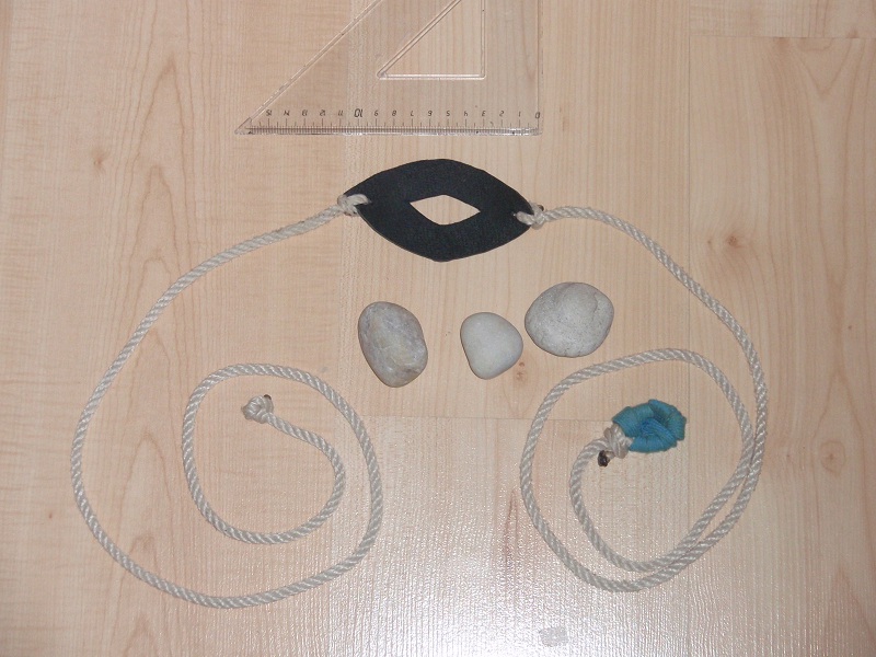

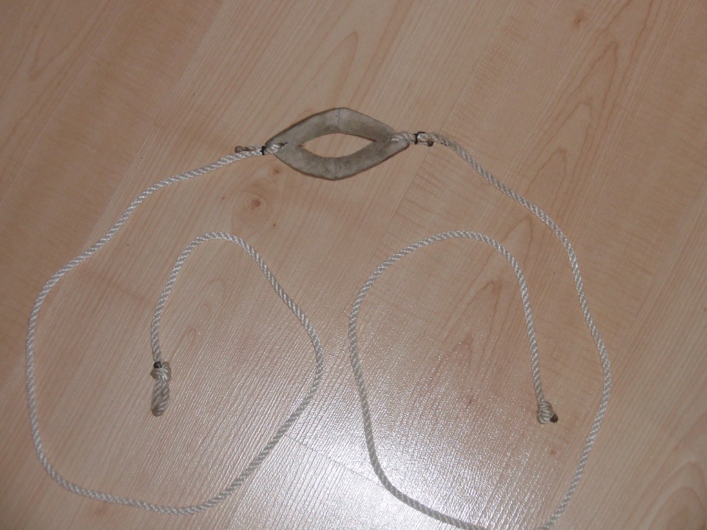

my sling

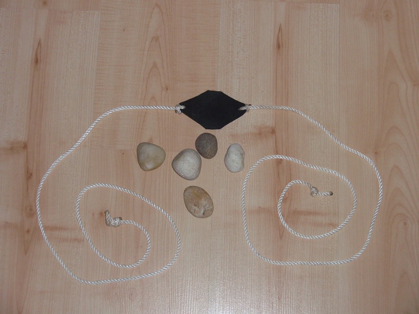

new sling

The slings are 80, 85 cm long and pouch is 10,5 x 5 cm

Nice job Sobieski. Never seen a pouch quite like that one. How does it work?

Thanks, it works very well. Sorry for my English

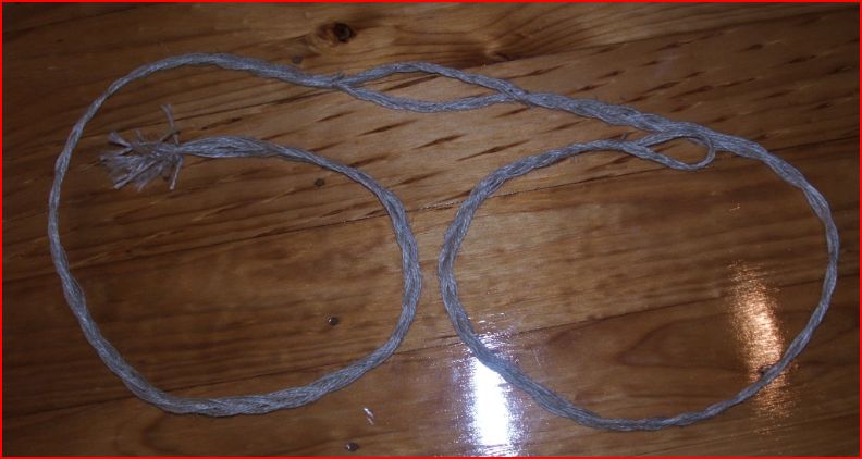

Here a Sling in the Balearic style. She corresponds him to her form then competition regulations of Tir de Fona.
She has in length of 60 cm and is made out of hemp fibers.

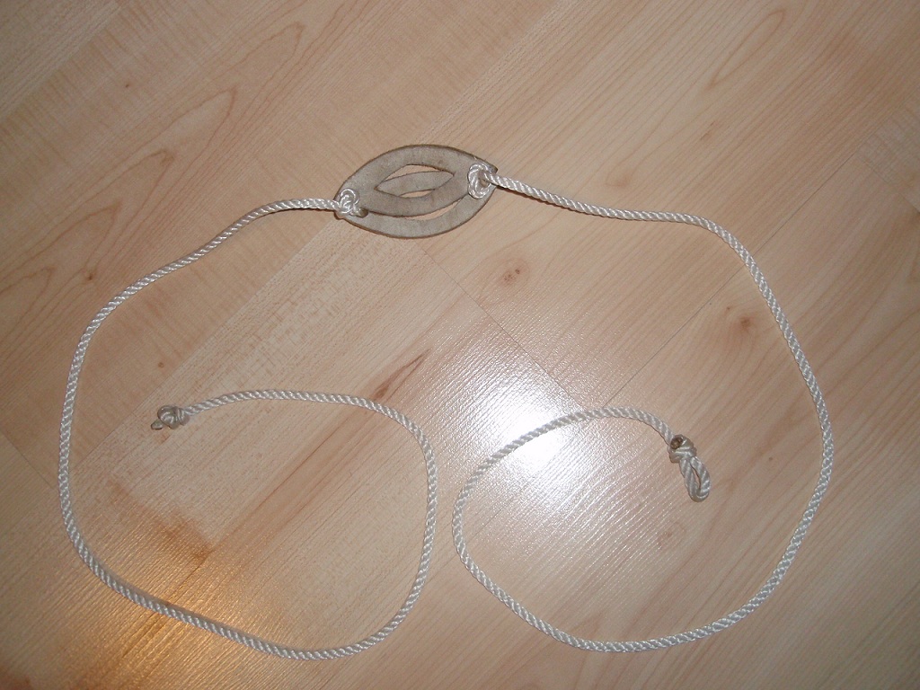

new sling (1,06 m long)

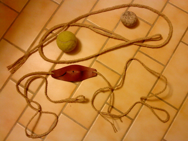

Here is my latest attempt at making a 5-strand braid Balearic sling.  I made a nice one recently, from flax/linen, but it came out thinner than intended.
And so I made this one.  28", flax, 5-strand braid, appear rather Balearic to me Cheesy
For making the previous one I began with 10 strands of apprx 1,3 mm, but for this new one I cut 15 strands.
So when the finger loop was braided, and I doubled it to continue braiding, I had 5 strands, each made up from 6 thin strands, to play with.  And they all wanted to stick together and get tangled.  Fortunately I knew before I started what to expect.
I almost feel like giving a little Mythbuster-like advice, though; Don`t do this at home, remember I`m a professional Grin
The other sling is an old leather pouch I re-stringed from 27" with utility cord to 39" with 3-strand braided hemp in case I want to include ammo such as lead fish sinkers, hex nuts or whatewer in my distance slinging.

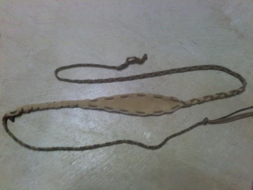

this is my new leather and paracord sling.  you might notice that the cords are slightly tapered yet at the same time 3 strips of parcord all the way through.  i did what i will call the "core taper"  i started to braid and when i got to a certain point i slid each of the outsides from each string down so that the core was exposed.  then i cut the core and stretch the shells bak out.  Then i kept braiding. this give a very clean  taper.
