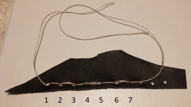

Here is an approximate replica of a York sling:
I was interested by the large holes at the ends of some of the artefacts compared to the smaller holes along the edges, which were themselves large compared to the hole made by sewing a pouch on with thread e.g. onto a braided sling.
I used thick jute twine and sewed it directly through the edges of the pouch. I used sticky tape on the working end to act as a needle, melted wax would have had a similar effect. Both cords pass through the final hole at each end, accounting for the larger size. The cords were reverse twisted together to form the release and retention cords. The finger loop was spliced back into itself. The pouch length is about six inches.
This works well and is a good way of using thinner leather for a pouch, since the tension is taken by the cords and not the leather itself. It is much quicker and simpler than making a braided sling with a sewn leather pouch.

DM-- sorry to be thick, but could you explain what you did ? Is it one single strand, or two strands (one for each side ?) ?
Title: Re: Leather sling pouches from York, UK.
Post by David Morningstar on Mar 6th, 2013 at 3:57pm
Two strands, one for each side which meet up at the final hole at each end and become a 2-ply reverse-twisted cord.
As it turned out, the number of holes I had punched (19 on each side, including the end ones) meant that the ends of the pouch 'stitching' were not the same. If I started by going down into the first hole then I finished by coming down out of the last hole. I wanted to be coming up out of the last hole so that the two ends would look the same.
I dealt with this by doing the two sides 180 degrees out of phase. If the left side was up-down-up-down then the right side was down-up-down-up. This made the ends the same but the sides were out of step. I can live with that. If this makes no sense to you, dont worry. It bent my brain a bit and I had it there in front of me.
The moral of the story is, there is a difference between using an even or odd number of holes.

David, this's the same I've made with my sling, except for bigger size and making 13 holes instead of 19.
Plus my pouch has some extra leather in the ends which I rolled around the string and fixed with tape.

Post by Kick on Jul 1st, 2019 at 5:39am
I got to try out the sling a little while ago and one problem was the pouch slipping on the cords. Should have expected it really. For now I've tied knots in the cords but it might need stitching somehow. Not exactly sure how I would do that but might give it a try some time.
Post by joe_meadmaker on Jul 1st, 2019 at 11:09am
Kick wrote on Jul 1st, 2019 at 5:39am:
I ran into the same issue with a pouch design I've recently started using.  The pouch looks kind of like an "X", and the arms wrap around the sides of a split pouch.  It was sliding around after each throw, so I attached it to the cords with contact cement.  Although I don't know if that would work with the sling you have because there's nothing to cover up the not-so-great looking contact cement areas.
I wonder if the pouch would hold in place if you looped the cord through each hold twice.  So each time you go through a hole, loop it back and go through the previous one again.  Does that make sense?
Post by Kick on Jul 2nd, 2019 at 5:42pm
I think I get what you mean. I think this style looks really nice and I'm sure I can get it to work it just needs fine tuning.
Post by joe_meadmaker on Jul 2nd, 2019 at 10:01pm
I gave what I was thinking a try.  And I'm glad I did, because it didn't work like I was picturing it in my mind.  It might still be worth a shot to see if it works for this style of sling.  Here's a picture of a sloppy test.
Here is how I did the stitch:
1. Down through hole 1
2. Up through hold 2
3. Down through hole 1
4. Up through hole 2
5. Down through hole 3
6. Up through hole 2
7. Down through hole 3
8. Up through hole 4.
9. Repeat.
You should see alternating segments of the cordage being doubled up.  Basically looping around each segment of leather, and the loop flips each time.
