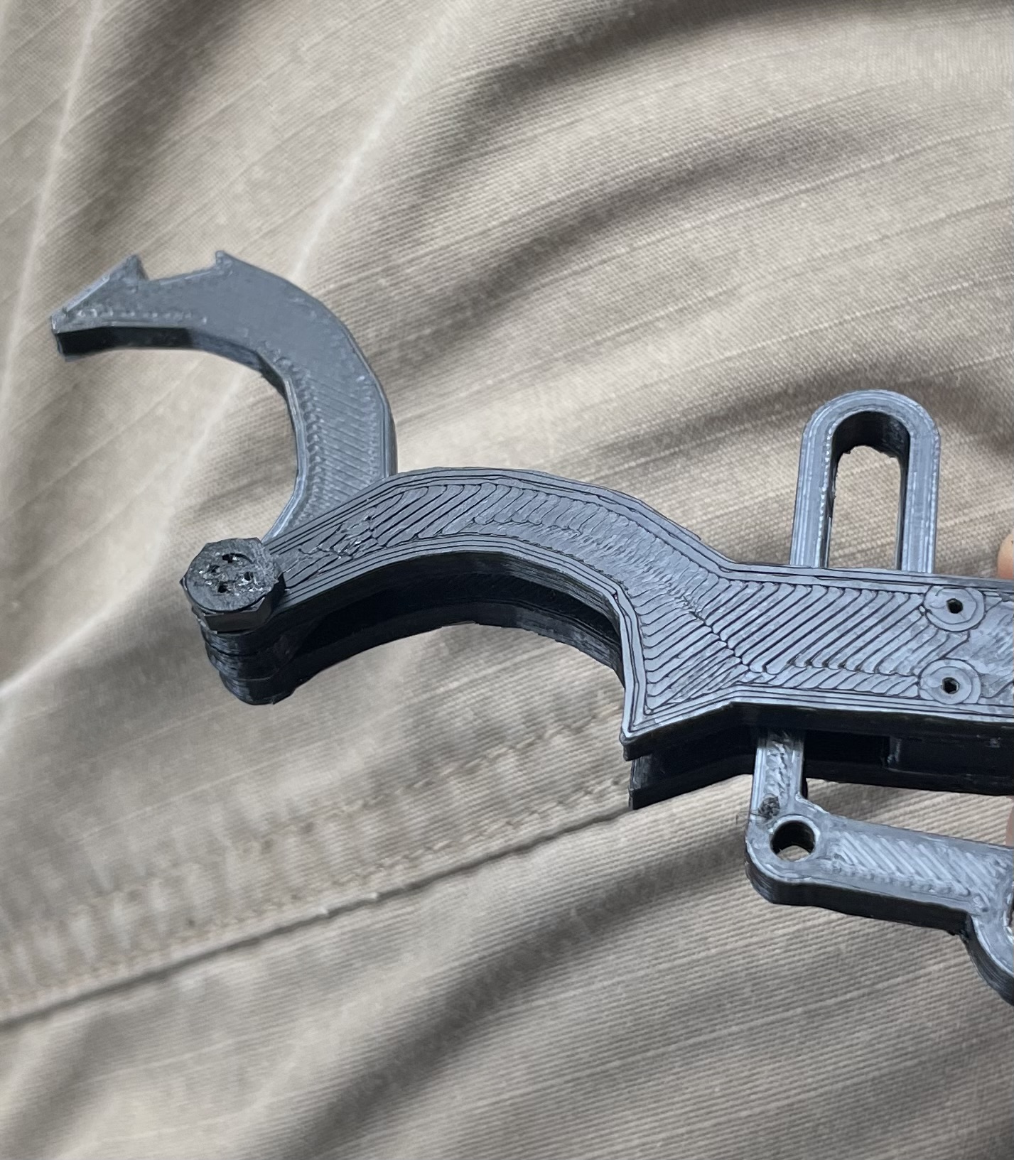

A simple overhand knot has always been perfectly acceptable for me… but just for fun, I just 3d printed a quick release… or I suppose you could call it the world’s smallest staff sling 😆
It’s super fast! …so fast that I feel like I forgot how to sling when I use it. I keep releasing the shot way too early and have no power whatsoever, but I’m tempted to try retraining my brain until I can actually hit a target with it.

Post by erricrice on Jun 24th, 2026 at 10:41am
Whoaaa, very cool! I've thought about doing something like this for a while, just never went to the trouble of designing it.
I would be interested to see some longer-term practice with it to see if it does result in improved consistency compared to a standard release.
Very interesting that your instinct gives you an early release with it - that indicates a standard release with a knot or tab has significant delay involved? I would have expected some change, but I would not have thought it would be terribly different between the two in terms of timing, moreso in consistency.

Post by NooneOfConsequence on Jun 25th, 2026 at 6:36pm
I haven’t fully analyzed the high speed yet, but for a rough order of magnitude on a linen balearic, I measured about a 50ms release time (from the moment the cord starts slipping until it disconnects from the hand). I am getting something around 10ms for a disconnect on the quick release clip. If those rough numbers are correct, then the quick release is 5x faster.

Post by bandit111964 on Jun 25th, 2026 at 10:19pm
Is the 3d printed quick release spring loaded??
Is that why it is so fast?
If it is spring loaded is the spring a linear spring or a torsion spring?
Title: Re: Any unique release ideas?
Post by NooneOfConsequence on Jun 26th, 2026 at 1:44pm
No, no springs. It’s passive… very much like a handcuff mechanism but smaller. It only opens if there is tension on the cord it’s holding.
Post by bandit111964 on Jun 26th, 2026 at 3:56pm
Fascinating!
Kind of like a rifle trigger with a sear. Bet re-working the geometry and some polishing you could alter the sliding contact to reduce trigger pull force if you wanted. Make it a hair trigger as an extreme example.
Also looks like heavier ammo pulls harder so heavier ammo should release even faster(???)….at least up to the point the heavy load binds the pivot.
Lots of potential with that mechanism!!
Post by NooneOfConsequence on Jun 26th, 2026 at 6:56pm
There’s no reason to lighten the trigger right now. It only takes ~100g of pull to release a 5lb load with the current design, but yes… lots of potential!

Correction… I meant to say 200g. Either way it’s not much!
Post by Rhodophyta on Jun 26th, 2026 at 7:22pm
Damn man that is a slick little mechanism. You could integrate that "little staff sling" into a full on staff sling pretty easily I think.
Would you be willing to share the STL (or 3MF, step, I'm flexible)?
