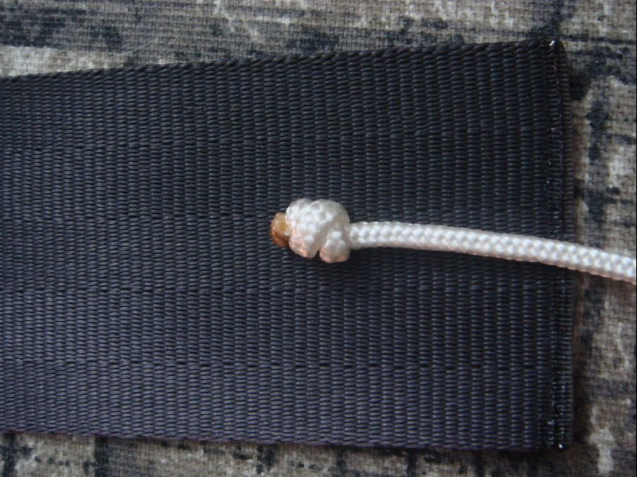

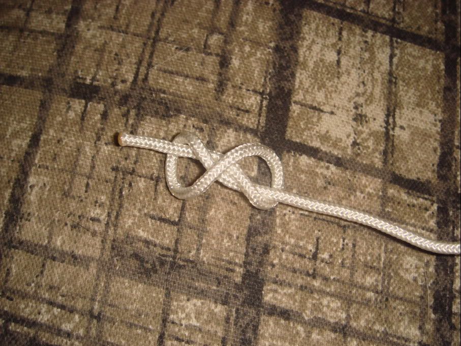

The Multiple-Overhand knot, which I used for what I will call the "nugget knot," which goes inside the M-fold:
The Multiple-Overhand knot, tightened:
The Multiple-Overhand knot nestled in the M-fold:

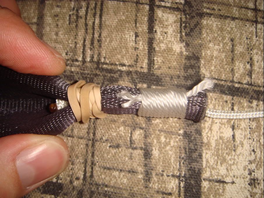

Setting up the whipping to cinch the M-fold:
The whipping, finished but without the ends melted:
The whipping, completed:

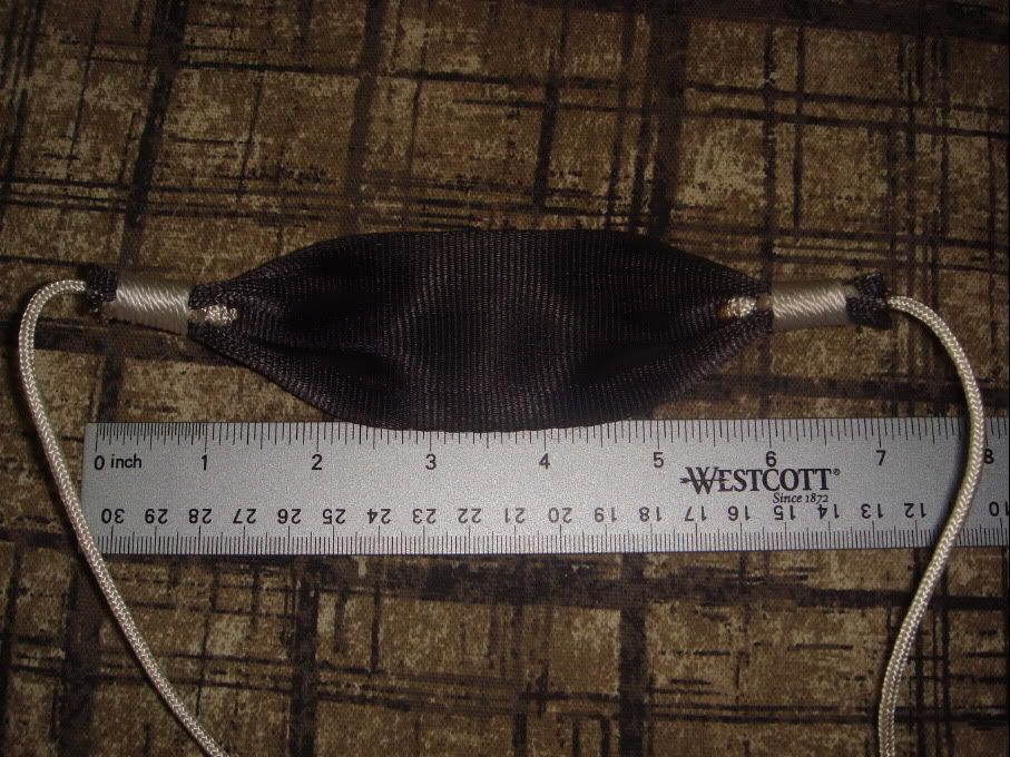

A finished sling:
The pouch with a foam golf ball loaded:
The pouch with a foam golf ball loaded (note, pouch is turned inside-out):
I have not taken the sling out for testing yet.  I have this to observe about the pouch, though:
The pouch does not exactly "cup" the ball.  What happens is the back of the pouch simple folds, while the ends of the pouch (at the whipping) have their own cupped shape which actually is what is responsible for retaining the ball; but the retention will be effective only while the pouch is held closed prior to a throw or by the centrifugal force of the throw as it is spun.
I have not decided (since it will depend on testing experience) whether it is better to use the pouch "rightside out" (with the nugget knots on the inside of the pouch) or "inside out" (with the nugget knots on the outside of the pouch).  When I began the project I was thinking it was a no-brainer that they'd be inside, but now that I have seen the sling in my hands, I think a good case might be made for putting them outside.  The edges of the pouch do different things depending on which way you close it.

Thanks so much for trying and so beautifully documenting your making of the seatbelt sling. Your workmanship is par excellence! I had intended to post a few more photos of my most recent slings but there's little point now.
Couple of things:
1. I prefer to use ordinary cotton string for the constriction bindings so that I can seal them with superglue. The glue soaks into the fibres of the strig and forms an almost plastic like solid mass with NO chance of unravelling.
2. I definitely use the the pouch with the nugget knots on the INSIDE (opposite to your photo.) As you say the pouch does not really cup the projectile at the bottom but the side indentations caused by the valleys of the M fold do hold the ball securely and I have had not trouble with several thousand shots by now. However, it probably would be a good idea to tailor the pouch to the size of ball being thrown by varying the pouch length. For tennis balls I think 7 1/2" of strap may be just a bit better than my original suggestion of 7" and if tailored to golf balls only 6" may be best. Of course it may vary a little depending on how long the constriction bindings are. Mine come in 1/2" from each end.
Once again thanks for trying the idea and for the excellent photos.
Regards,
Aussie.
PS  I found it easiest to do the M fold first and hold it in place with a rubber band as you have shown, and then to insert the cord into the valley. Forming the M fold around the cord is harder to hold in place.
« Last Edit: Jul 9th, 2009 at 6:57pm by Aussie »
