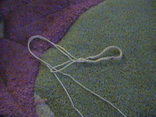

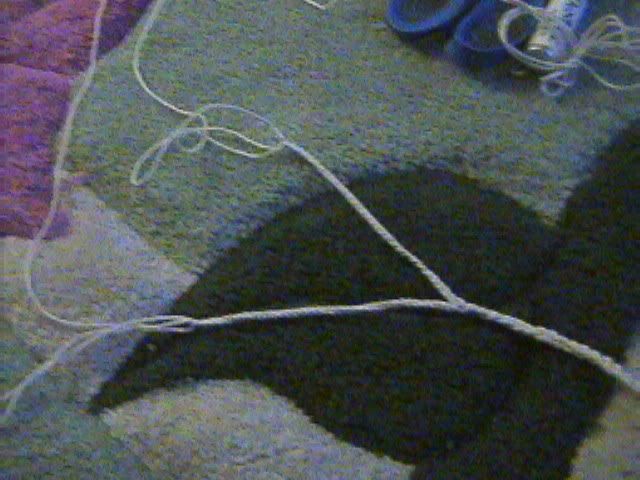

since this is post # 1000 for me, i wanted to do something special.
The Monkey Chain Knot Sling
one day when i was sitting in the car playing with some string, the idea occured to me: why not make a sling using the monkey chain knot?  so i played around with the idea, and here is the result:
warning: if you don't know how to do the monkey chain knot, you will be unable to make this sling.  to learn how to do it, look at this link
except for tight, and knot loose  Wink
well, first you need to figure out how long you want the final sling from the end of the finger loop to the end of the release cord.  now multiply this by four, and that is how long your string needs to be for this sling.
double up the string and find the half way point.  now mark about 5 inches on each side of the center line.
now you start the first loop at one of the marks, and MC to the other loop, but remember this: look at where the chain ensd, not where the loop lands on the string.  once the finger loop is done, go to the next step
this is probably the trickiest part of the whole thing.  now you double over the finger loop so that the two ends of the chain are next to eachother.  now take the loop and put the two strings into the loop instead of just the one.  this  is hard because in order to make the next loop (a double by the way) you have to keep the loops the same size
now keep going with the MC until you reach the point where you want to start the pocket
now seperate the loops and figure out which loop goes with which string
start with the MC again, but with a single strand.  the nice thing about the MC is that unlike a braid, it will not come undone if you put it down for a minute
now finish the pouch to where you want it to be
double up the loops and start up the MC until the sling is completed.  then at the end to lock it into place, just pull the end of the string through the last loop and pull it tight.  then the only way to undo the knot is to pry the last loop open and tug out the string.
here's the finished sling:
and just like a braided sling, you can add more strands for a thicker sling.
well, there you go.  i hope you enjoy.

oh yeah sorry about all those pics, but it's sortof hard to understand without them(and even with them  Grin )

pics are cool Grin and euhm Yeah it still is kinda hard to understand Tongue But i'll figure it out  Grin
